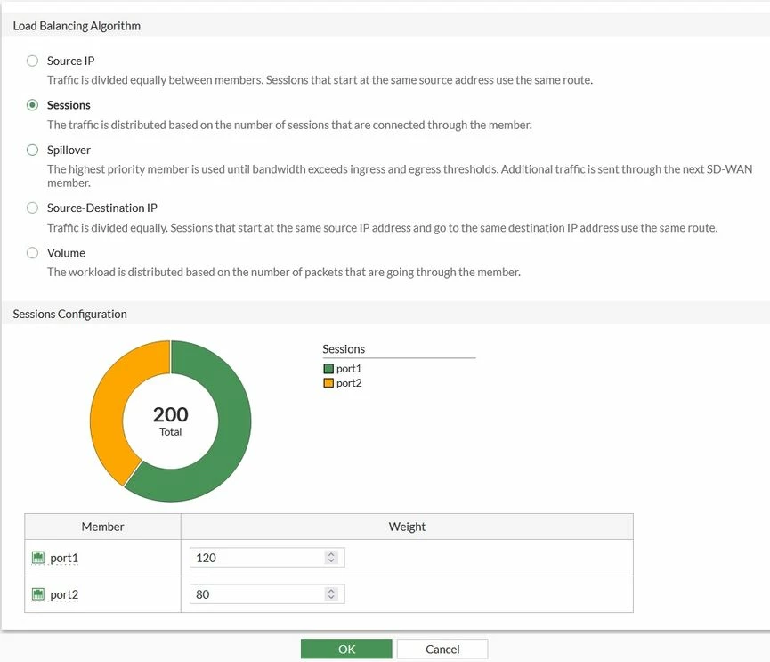

  1. When configuring weights on each member, the traffic will be sent out based on the distribution percentage of the weight.

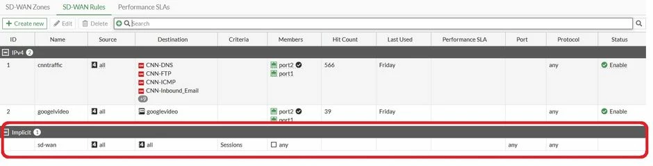

  1. Weights are applied only for implicit rule traffic on SD-WAN rules.
By default, session is selected as the load balancing algorithm and can be changed as below:
  1. Traffic generated based on SD-WAN rules, apart from implicit rules, does not use a weight factor to send out traffic.

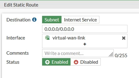

  3. To have the effect of weight distribution on implicit traffic, it is required to set the static route using the SD-WAN zone as the interface, not individual members.
