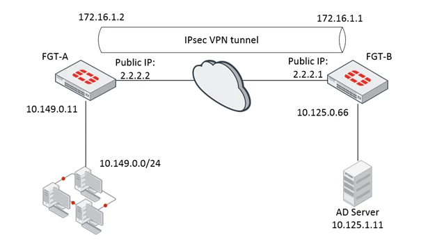

This article describes how to configure Agentless FSSO Polling via IPsec VPN tunnel between two FortiGates.
Refering to the network diagram above, AD server is only reachable by FGT-A by IPsec VPN tunnel to FGT-B. By using FSSO Agent, we can specify the source IP to reach FGT-B. However, there is no such option in Agentless FSSO polling.
LDAP is configured to specify source IP, but performing sniffer on FGT-A with port 445 reveals it was being sent out using another source IP:

2.2.2.2 is the public IP of FGT-A and it is not supposed to be traversing through the IPsec VPN tunnel VPN-AtoB, thus traffic will be dropped by remote FGT.
By configuring IP address on the IPsec VPN tunnel, we can force the FSSO traffic to use the VPN tunnel IP address instead of the lowest index IP address as source IP.
