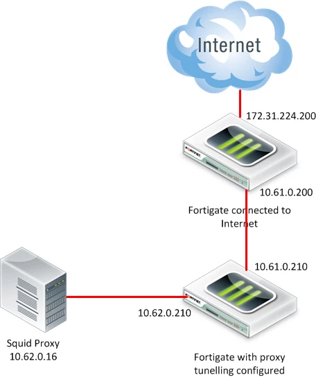

Here is a sample network diagram:

Configuration of the FortiGate unit (CLI):
config system auotupdate tunneling
    set address 10.62.0.16
    set port 8080
    set status enable
Configuration of the Squid proxy (squid.conf):
acl myfgt src 10.62.0.210
http_access allow myfgt
