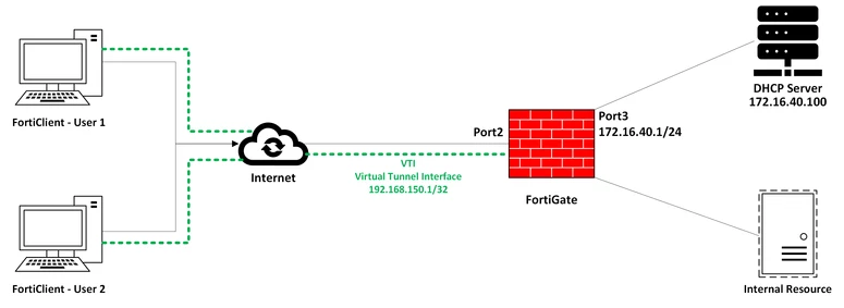

Description This article describes the steps to configure and bind a static IP address to a designated username in an IKEv2 dialup IPsec scenario by using an external DHCP Server and FortiClient.
Scope FortiGate, FortiClient.
In certain scenarios, a specific Dialup IPsec client must receive a designated IP address from an external DHCP server. To accomplish this, DHCP Option 61 (Client Identifier) can be used, serving as the key identifier for binding the client to a static IP address.
Basic requirements for proper functionality:
  1. The DHCP proxy must be enabled on the FortiGate device.
  2. The DHCP server must know how to route back to the IP address specified in the FortiGate's 'dhcp-ra-giaddr' setting.
The dhcp-proxy option enables DHCP proxy functionality on the FortiGate for remote-access VPNs such as dial-up IPsec and SSL VPNs that use DHCP-based address allocation.
DiagramDiagram

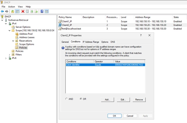

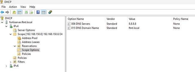

Step 6: Create the appropriate DHCP Scope using the IP Range defined in the dhcp-ra-giaddr setting:
Note: Configuring a default gateway for the scope is not required.
DHCP Scope OptionsDHCP Scope Options
DHCP PoliciesDHCP Policies

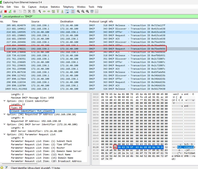

On a Windows DHCP Server, the Client Identifier (Option 61) must be specified as a HEX value. Therefore, the username used by the client for authentication must be converted to HEX format. This information can be easily obtained by capturing the DHCP Request packet and analyzing it in Wireshark.
Important: Ensure that the Client Identifier HEX value includes the type field. Omitting it may cause the DHCP server to bypass the intended policy.
Example:
fct_client1 = 6663745F636C69656E7431 in HEX format.
By including the type byte, the HEX value becomes: 006663745F636C69656E7431.
DHCP Request PCAPDHCP Request PCAP

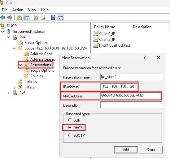

Alternatively, address reservation can be used, which only requires the HEX-encoded username without the type byte.
DHCP ReservationDHCP Reservation
Note: When using address reservation, the HEX-encoded username should be entered in the MAC address field.

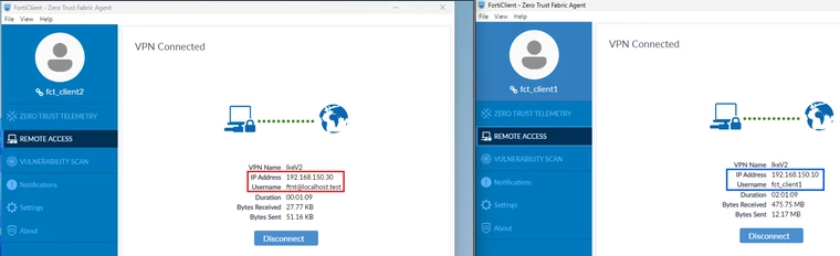

If configured correctly, users authenticating via FortiClient will receive the IP address assigned by the DHCP server.
