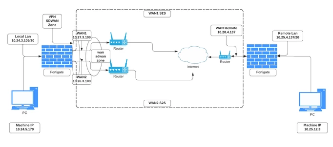

Consider the following scenario.
Assume the SD-WAN is already configured for the ISP. This is not a requirement for this setup but it is recommended to have the ISP integrated with SD-WAN.
Version 7.2.0 has been used to configure this setup.

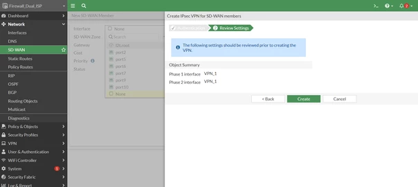

  1. Configure the VPN Interface manually, not from IPsec Wizard, as the interface created from IPsec wizard cannot be called in the SD-WAN member. When the tunnel is created from IPsec wizard, it creates routes, policy, addresses, etc., and to configure FortiGate interfaces as SD-WAN members, it is necessary to remove or redirect existing configuration references.
A new wizard was added for SD-WAN VPN to avoid error-prone configuration.

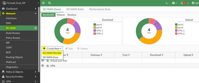

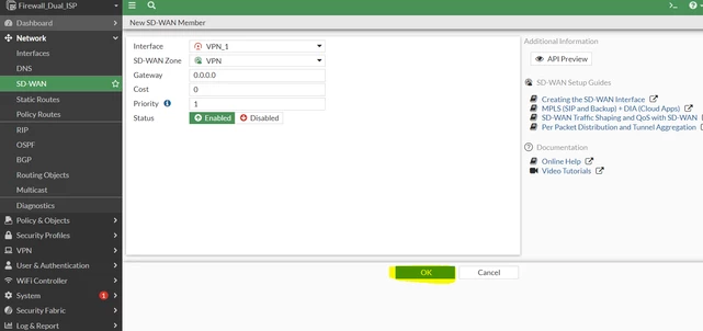

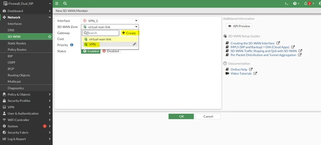

Navigate to Network -> SD-WAN, and select 'Create New' -> SDWAN Zone, the name VPN has been used, do not add any members as of now.

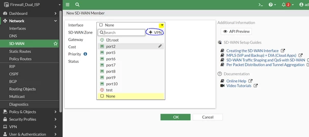

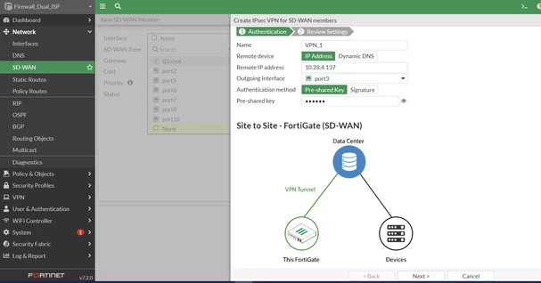

Create an SD-WAN Member:
Navigate to Network -> SD-WAN, select 'Create New' -> SDWAN Member.
Select +VPN in the Interface drop-down to open the Create IPsec VPN for SD-WAN members pane.
Enter the required information, then select 'Create'.
Name - Appropriate Tunnel Name (VPN_1).
Remote Device IP address/ DDNS - The IP address has been used.
Outgoing Interface - The WAN 1 (For the setup it's port 3).
Authentication Mode - Pre-Shared Key/Signature (the pre-shared Key has been used).
Pre-Shared Key - (Define preshared key).
Review the settings and create the Interface.
  1. Add the Interface in the respective zone. If a VPN zone has not been created for VPN, create one and the interface to it.
Follow the same process to create the second VPN tunnel and add it in the same zone.

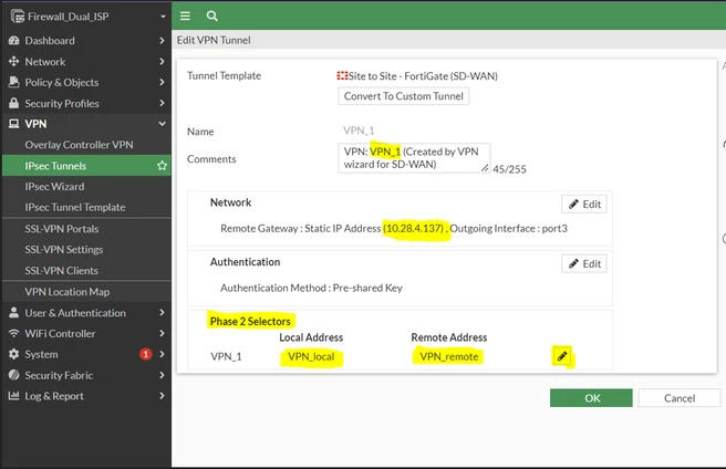

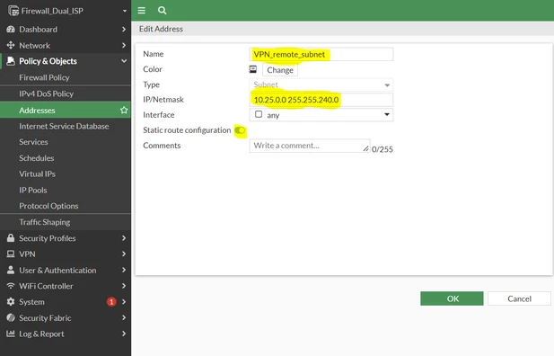

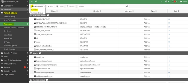

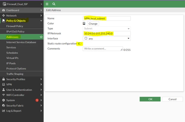

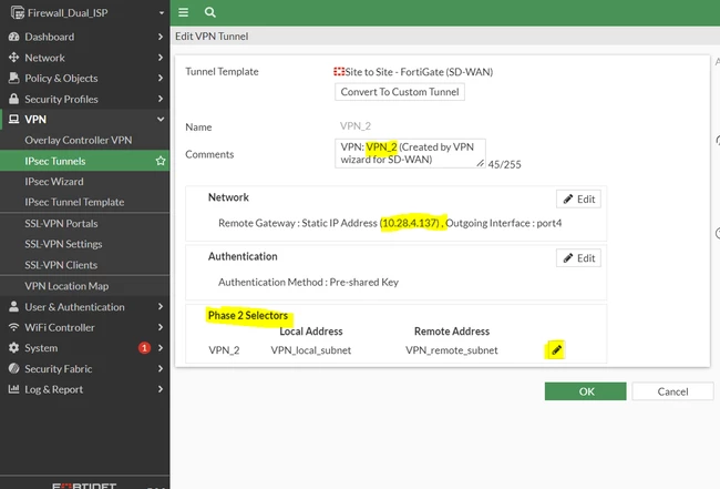

  1. Change the VPN traffic selector as per requirement, as with the SD-WAN Wizard, it will create any and any. Configure the Address:
    Go to Policy & Object -> Addresses, select 'Create new' - Address (Configure the local and remote address as per requirement). In this setup, local - 10.24.0.0/20 and Remote 10.25.0.0/20.

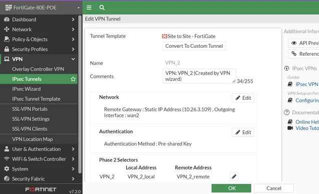

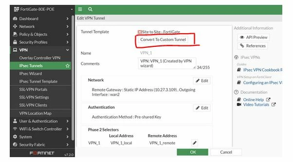

If it is not desired to use this IPsec connection to go to Internet, go to VPN -> Ipsec Tunnel -> Respected Tunnel and change the phase 2 selector.

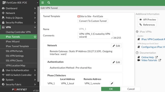

Verify the Tunnel configuration by going to the VPN -> Ipsec Tunnel - > VPN_1 & VPN_2.
To make changes to the algorithm/encryption in phase-1/phase-2 or IKE version, select 'Convert To Custom Tunnel' under the Tunnel Template as shown in the following figure.

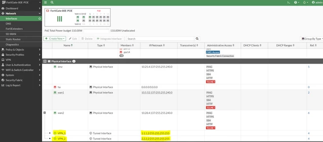

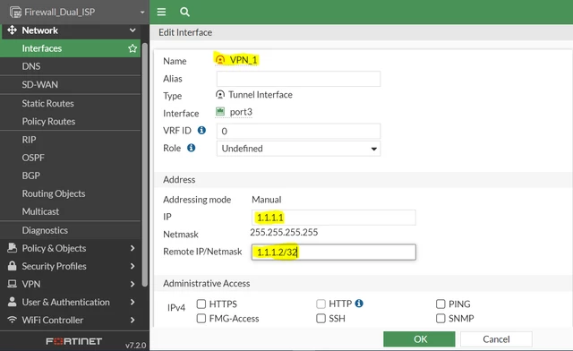

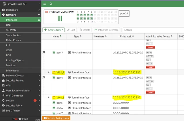

  1. Go to the respective VPN Interface and assign an IP address to the Interface. Any gateway has been defined when configuring the SD-WAN member, as even if any gateway has been configured there, it will again populate it with 0.0.0.0. Go to Network -> Interface -> Expand the WAN 1 and edit the VPN_1 interface.
Define the local and remote interface IP, 1.1.1.1 and 1.1.1.2 have been used for VPN_1 & VPN_2 -> 2.2.2.1 and 2.2.2.2.
  • The IP addresses selected are random IP addresses that must not be part of the subnets configured in the FortiGate, to avoid any conflicts. It is ideal to configure subsequent IP addresses to ease the identification of the tunnels. Create the Static Route for the VPN traffic using the VPN SD-WAN zone created if it is running v7.0 and above.

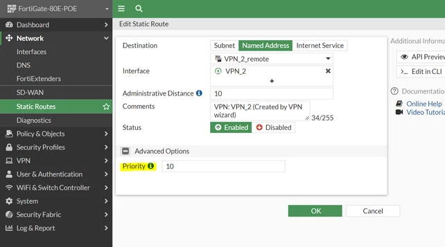

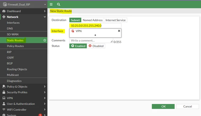

Go to Network -> Static Route, select 'Create New' (Enter the required information,) and select 'Ok'. The following snippet is from FortiOS v7.0.0.

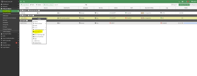

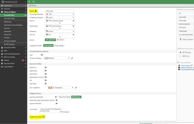

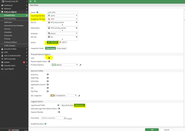

  1. Create the Firewall policy for the respected VPN traffic using the VPN SD-WAN Zone:
    Go to Policy & Object -> Firewall Policy, select 'Create New', select the respected interface for LAN to VPN communication, and add the required attribute.
Ensure NAT is disabled in the policy, otherwise, the traffic will use the tunnel Interface IP. If the peer end Internal LAN has no route for the tunnel Interface IP, the traffic will be dropped at the peer end Internal LAN.
Once the policy is created, it is possible to do a clone of the policy, change the name and switch the source and destination (reverse them) and enable the policy.

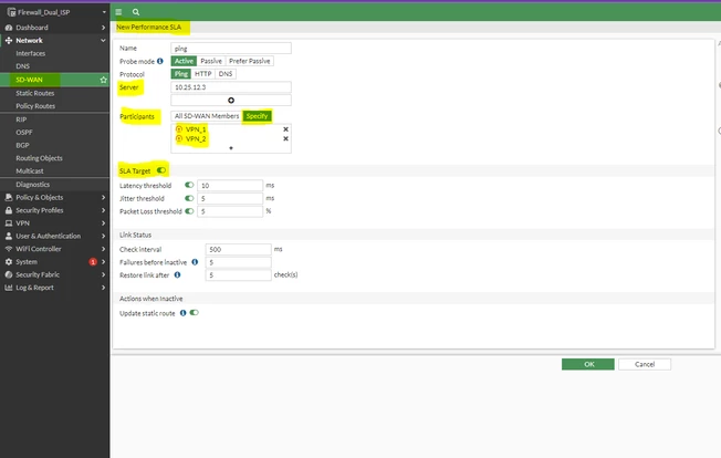

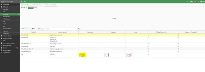

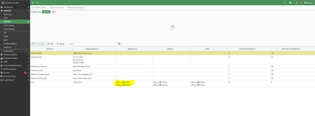

Configure Performance SLA for VPN Interface in SD-WAN: Go to SDWAN - > Performance SLA, select 'Create New', and define the parameter (peer-end Local LAN machine IP has been used, as the server 10.25.12.3).
However, after the configuration, the Performance SLA will still be down.
Add the source in the SD-WAN VPN member from CLI to get this SLA working.
config system sdwan
    config members
        edit 4
            set interface "VPN_2"
            set zone "VPN"
            set source 10.24.3.109 <----- Added LAN interface IP.
         edit 5
            set interface "VPN_1"
            set zone "VPN"

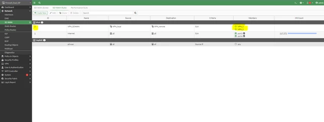

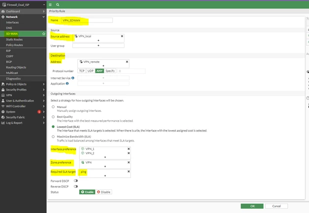

Create the SD-WAN Rule using the same performance SLA:
Go to Network - > SD-WAN Rules, select 'Create New', define the Parameter (the strategy as Lowest cost SLA has been used, it is possible to refer to the related articles and check which is suitable for the network, it is possible to configure either redundant or else load-balanced).
Latency, Best Quality, and Lowest cost SLA will use one interface at a time but with Maximum bandwidth the Traffic is load-balanced among interfaces.
Verify the VPN rule is above the all to all rule as the rule works top to bottom.

    • Once everything is created, it is possible to change the Priority of the route as per requirement, it is also possible to leave it as it is, to manage the tunnel from the Firewall which has the dual-link only.
