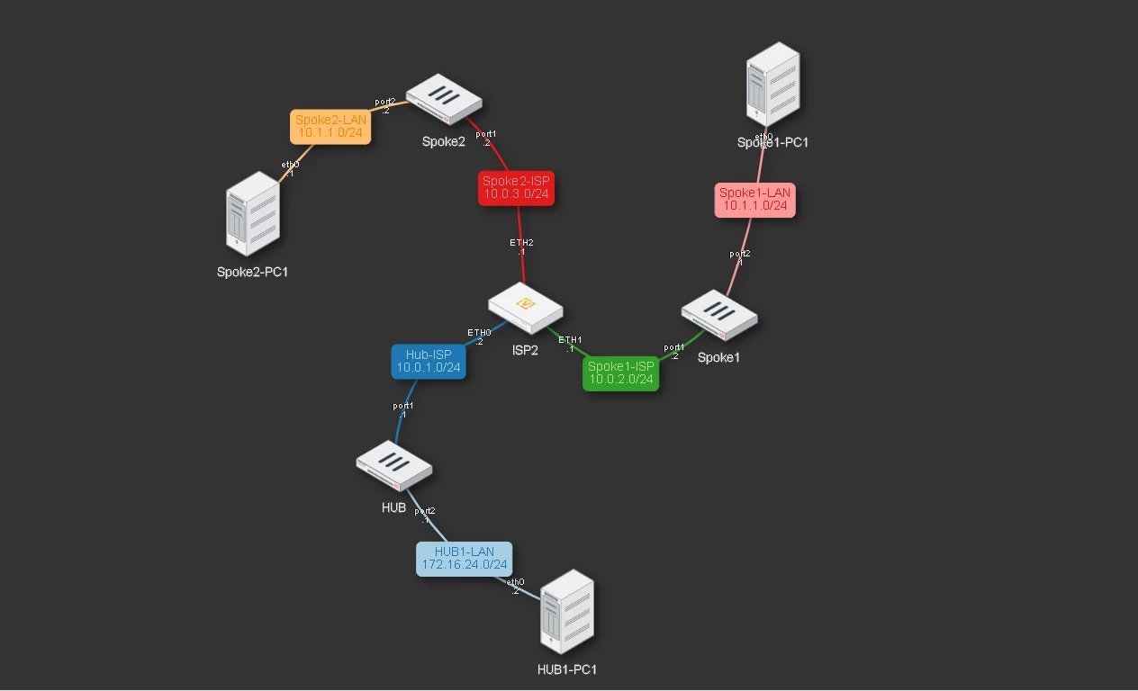

Topology:
In this topology, spoke1 and Spoke2 have overlapping LAN subnets as 10.1.1.0/24. Whereas the hub has a LAN subnet of 172.16.24.0/24.
If IPsec tunnels are created without the steps below then the hub would have a route to 10.1.1.0/24 from both the tunnels and may create unwanted routing issues in the network.
In this case, one of the spoke needs to NAT the traffic to another subnet so that the hub can differentiate between the traffic on each spoke.
Spoke1 in this case will NAT the traffic of subnet 10.1.1.0/24 to subnet 10.8.8.0/24.

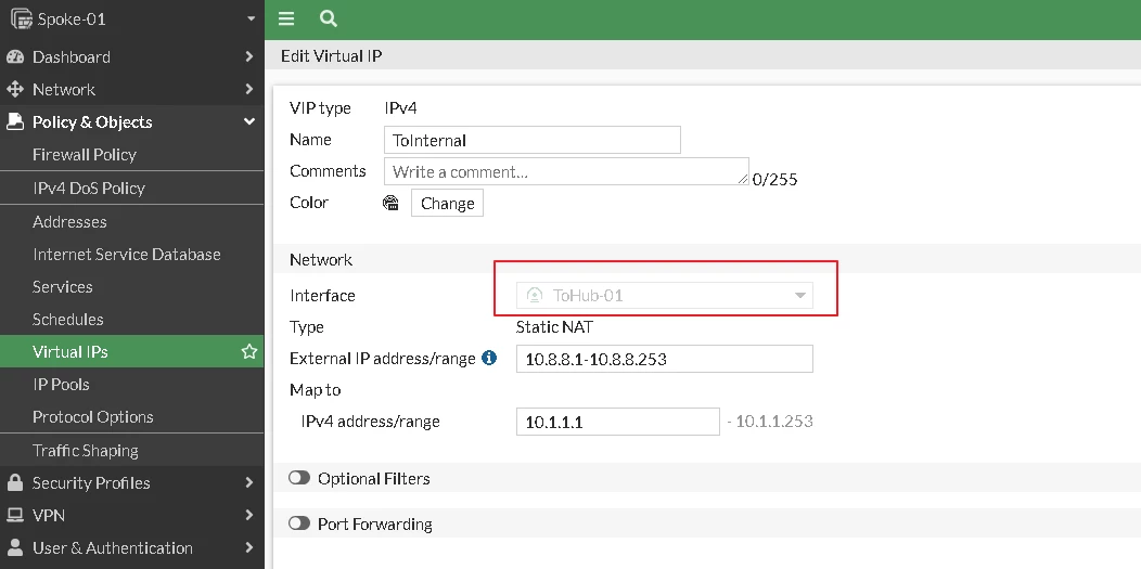

  3. Create a VIP on Spoke1 to DNAT the traffic from 10.8.8.0/24 to 10.1.1.0/24
    Navigate to Policy and Objects -> Virtual IPs -> Create New.
    Make sure to select the tunnel interface in the interface field.
    CLI:
    config firewall vip
        edit "ToInternal"
            set uuid a957d080-4a09-51ef-ad23-f92d9327b98e
            set extip 10.8.8.1-10.8.8.253
            set mappedip "10.1.1.1-10.1.1.253"
            set extintf "ToHub-01"
