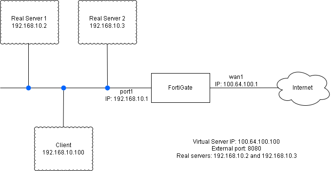

This article describes how to set up a hairpin NAT to allow clients located behind the same interface as the real servers to access services using the virtual IP address.
FortiOS v7.4+.
This article assumes that the Virtual Server is already configured and is accessible from external interfaces such as the WAN. In this example, the Virtual server is configured as follows:

For information on how to configure a virtual server, refer to the following article: Technical Tip: Configure a virtual server.
If the Client machine with IP 192.168.10.100 needs to connect to the virtual server using the external IP address 100.64.100.100,
The following changes need to be applied.
Step 1: Change the external interface in the VIP to 'any'.
