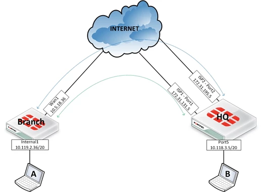

The scope of this article considers that HQ has 2 Internet connections called ISP1 and ISP2 shown in the diagram with Blue and Green lines describing the different paths
    - ISP1 is connected to port1.
    - ISP2 is connected to port2.
    - Branch has 1 internet connection with 2 IPSEC tunnels toward HQ ISP1 and HQ ISP2.
    - All traffic from the Branch has to go through HQ, i.e. Branch users connect to the internet through HQ.
    - Internet security policies are applied to HQ.
The routing preferences are :
    - Branch to HQ : 1 Blue VPN, 2 Green VPN
    - Branch to Internet (through HQ) : 1 Green VPN, 2 Blue VPN
    - HQ to Branch : 1 Blue VPN, 2 Green VPN
    - HQ and Branch to Internet : 1 ISP1, 2 ISP2
The best path selection is based on the configured service level agreement (SLA).
The following solution explains how to configure the HQ and Branch FortiGates

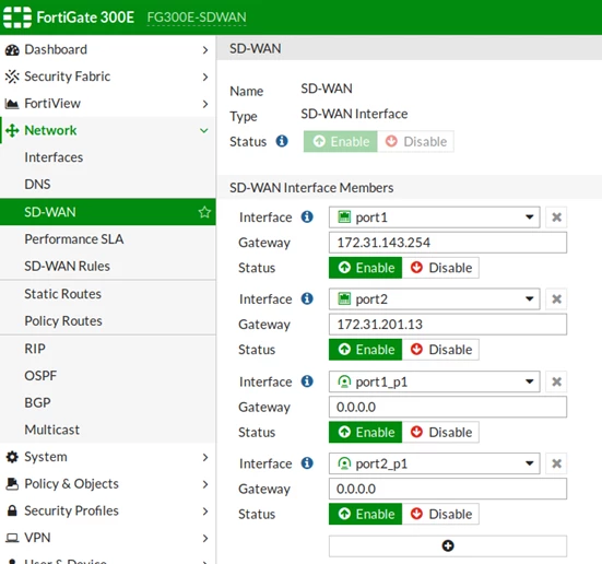

2. Add port1 (ISP1), port2 (ISP2), port1_p1, port2_p1 to SD-WAN:
port1_p1, port2_p1 have no gateway since they are tunnel interfaces
config system virtual-wan-link
    set status enable
    config members
            set interface "port1"
            set gateway 172.31.143.254
            set interface "port2"
            set gateway 172.31.201.13
        edit 3
            set interface "port1_p1"
        edit 4
            set interface "port2_p1"

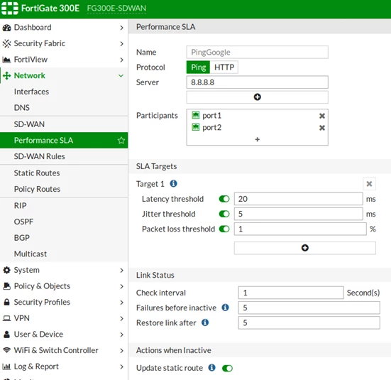

3. Configure separate health-checks for the internet connection and IPSEC VPNs:
config health-check
        edit "PingGoogle"
            set server "8.8.8.8"
            set members 1 2
            config sla
                    set latency-threshold 20
                    set packetloss-threshold 1

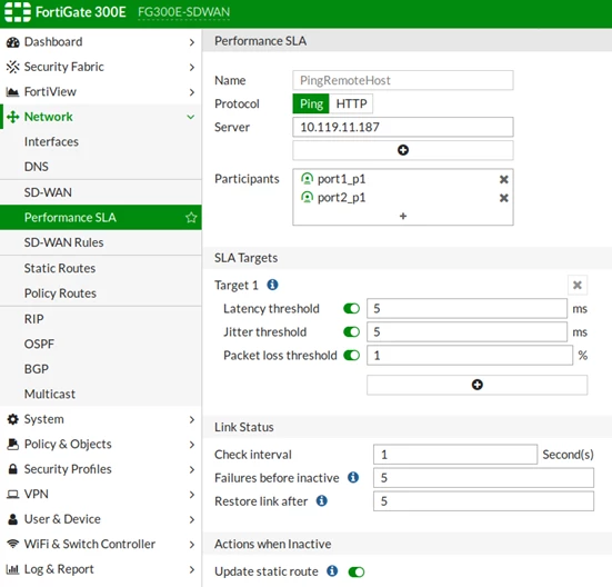

        edit "PingRemoteHost"
            set server "10.119.11.187"
            set members 3 4
            config sla

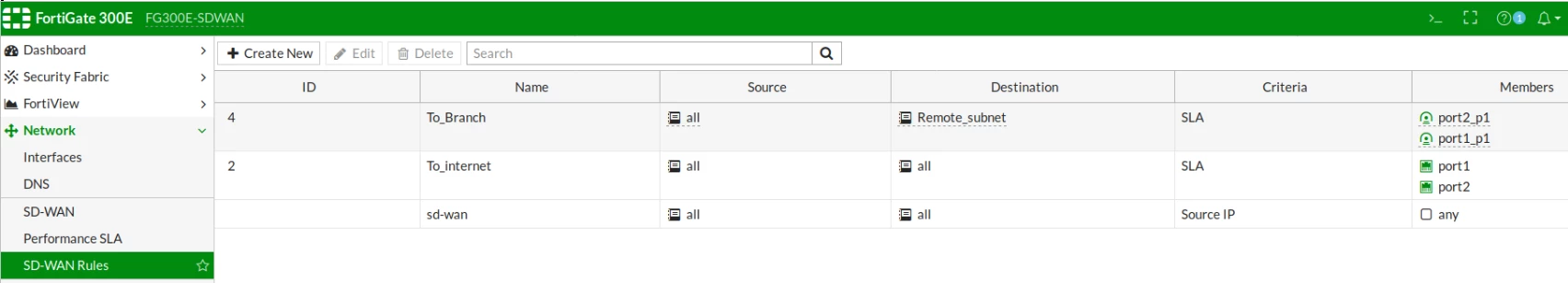

4. Configure SD-WAN rules and address objects:
config firewall address
    edit "Tunnel_port1"
        set subnet 1.1.1.0 255.255.255.252
    edit "Tunnel_port2"
        set subnet 2.2.2.0 255.255.255.252
config service
        edit 4
            set name "To_Branch"
            set mode sla
            set dst "Remote_subnet"
            set src "all"
            config sla
                    set id 1
            set priority-members 4 3
            set name "To_internet"
            set mode sla
            set dst "all"
            set src "all"
            config sla
                edit "PingGoogle"
                    set id 1
            set priority-members 1 2

Verify the configuration
Health check status:
FG300E-HQ # diagnose sys virtual-wan-link health-check
Health Check(PingGoogle):
Seq(1): state(alive), packet-loss(0.000%) latency(4.140), jitter(0.138) sla_map=0x1
Seq(2:( state(alive), packet-loss(0.000%) latency(4.082), jitter(0.032) sla_map=0x1
Health Check(PingRemoteHost):
Seq(3): state(alive), packet-loss(0.000%) latency(1.699), jitter(0.080) sla_map=0x1
Seq(4:( state(alive), packet-loss(0.000%) latency(1.843), jitter(0.376) sla_map=0x1
