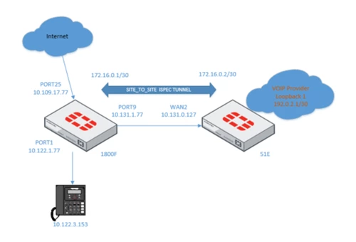

There are situations when, multiple links are needed to reach different resources.
For example, a link used for all Internet traffic and another one for voice traffic.
In most common cases a firewall policy with NAT enabled is used to allow traffic from the local LAN towards the Internet.
By default, when SNAT is used, FortiGate preserves the existing session when a routing change occurs.
This might cause some traffic not to be routed as expected.
This article describes how to configure the FortiGate to avoid routing issues after a route change when SNAT session preservation is used.
In this example, the Phone has the IP 10.122.3.153, and must reach the PBX at 192.0.2.1.
There is an IPSEC tunnel between the FortiGates and a BGP session over that tunnel.
The Fortigate 51E advertises, via BGP, the prefix 192.0.2.1/30.
A new session is created and, according to the configured firewall policy, SNAT is applied.
FG180F-3 # diagnose sys session listAfter the BGP peering is UP again, although the FortiGate has a better route to the PBX network, the host is still unable to reach the 192.0.2.1 IP as the session is still active.
