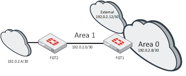

Topology:
1) Both Fortigates communicate each other in the subnet 192.0.2.0/30, this network belongs to Area 1.
2) Fortigate FGT1 is an ABR on Area 0 and Area 1, as well as an ASBR redistributing the route 192.0.2.12/30. FGT2 is a router in Area 1.
3) Network 192.0.2.4/30 belongs to Area 1.
4) Network 192.0.2.8/30 belongs to Area 0.

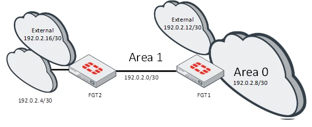

CASE 3: Area 1 as a Not-so-stubby area (NSSA).
Topology:
FGT2 is now an ASBR and it’s advertising the prefix 192.0.2.16/30 while being a router from Area 1.
