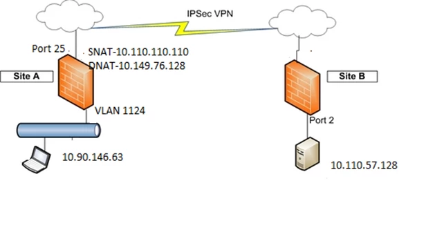

Scenario.
[Client] ( Src IP:10.90.146.63) –Dst IP: 10.149.76.128) <-----> [FGT] (Src NAT IP: 10.110.110.110 –Dst NAT IP: 10.110.57.128 ) <-----> IPSec tunnel <-----> [FGT] (Src IP: 10.110.110.110 –Dst IP: 10.110.57.128 ) <-----> DST(10.110.57.128
The requirement is the traffic from the source 10.90.146.63 need to reach the destination server 10.110.57.128 via the IPSEC tunnel which need to source NAT 10.110.110.110 and destination NAT 10.149.76.128 from Site A FortiGate.
Topology.
Topology.
CLI configuration example.
