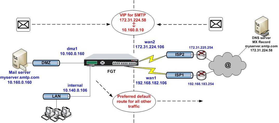

This document describes why and how to use Policy Based Routing with a Static VIP (Virtual IP) in a dual WAN scenario.
  • FortiGate or VDOM running in NAT mode.
  • Configuration and verification steps for FortiOS 4.0
Expectations, Requirements:
In the setup above, the expectations and requirements are:
  1. The SMTP server is known and accessible from the Internet with its 'public' IP address associated to the VIP: 172.31.224.58 (MX record in DNS servers), via wan2/ISP2.
  2. The SMTP server, when initiating traffic towards the Internet, must use the same the same source IP address 172.31.224.58.
    This is the reason to use a Policy Based Routing, which will push the traffic on wan2 in order to benefit from the VIP translational in the other direction.
  3. All other traffic, from either the DMZ or the LAN must be routed via wan1/ISP1 normal routing process.
  4. In case of wan1 failure, routing failover for all other traffic is ensured over wan2.
Failover of SMTP services and VIP is not in the scope of this article. This can be achieved with a second MX record and/or with dynamic routing protocols. For this last option, see 'Static NAT VIP accessible from 2 external interfaces with E-BGP peerings' in the related articles at the bottom of this article.
Note that this could apply to other services than SMTP, like HTTP or HTTPS for example.

  • The secondary default route via wan2 has got a higher priority value (less preferred) is used to:
  1. Allow packet ingressing wan2 from the internet.
  2. Be used as backup default route in case of wan1 failure.
  • In this scenario, only one Policy Based Route is used to force traffic with destination port 25 to egress on wan2. This is to benefit from the bi-directional address translation created with the VIP.
  • Firewall Policy 7 has a deny action to prevent SMTP traffic to be sent via wan1: this will avoid that SMTP traffic being sourced with another IP address than the one published by the MX record (SMTP failover is not covered in this article).
  • Despite the Policy Based rule, a Firewall Policy is still necessary (policy id 6) from input-device to output-device as defined in this rule.
  • Bi-directional VIP translation requires to NOT use port forwarding in the VIP definition.

See from both traces above that traffic with destination TCP port 25 sourced from 'dmz1' is sent on wan2 while all other traffic is sent on wan1.
It is important to note that the SMTP traffic is source on wan2 NATed with the VIP address 172.31.224.58.
