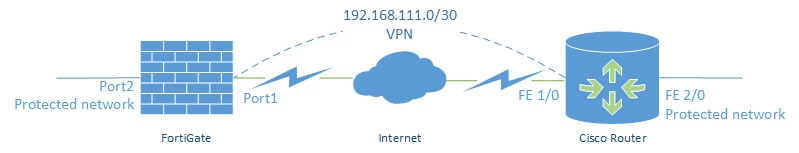

This article describes that this configuration example is a basic VPN setup between a FortiGate unit and a Cisco router, using a Virtual Tunnel Interface (VTI) on the Cisco router. The IPsec configuration is only using a Pre-Shared Key for security. XAUTH or Certificates should be considered for an added level of security. Only the relevant configuration has been included.
When creating VPN configurations using the "interface-based VPN" on a FortiGate unit and the VTI on a Cisco router, it has the following advantages:
• a more simple setup,
• Proxy-ID/Quick Mode Selectors are not needed,
• using a dynamic routing protocol (such as OSPF) is rather straightforward.
As an additional example, a BGP configuration in this scenario would be as simple as creating neighbor statements on each device.
Testbed platforms used in this scenario:
• FortiGate unit running FortiOS firmware version 5.0.2.
• Cisco router running IOS 15.0(1)M.
