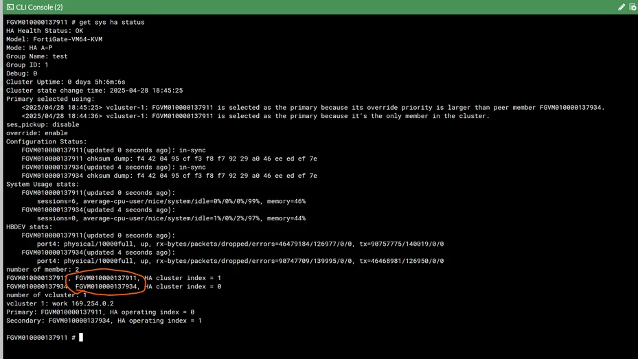

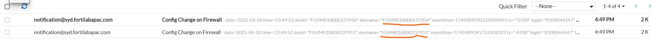

  1. Once the configuration change has occurred on the firewall, two emails have been received, one from the Primary device, followed by another email same content, with the Secondary device serial number, see example below and screenshot
date=2025-04-28 time=23:49:55 devid="FGVM010000137934" devname="FGVM010000137934" eventtime=1745909395651268351 tz="-0700" logid="0100044547" type="event" subtype="system" level="information" vd="root" logdesc="Object attribute configured" user="admin" ui="ha_daemon" action="Delete" cfgtid=156041243 uuid="0b7d630e-248b-51f0-67a7-190c989b53d4" cfgpath="firewall.address" cfgobj="none" msg="Delete firewall.address none"
date=2025-04-28 time=23:49:55 devid="FGVM010000137911" devname="FGVM010000137911" eventtime=1745909394668896417 tz="-0700" logid="0100044547" type="event" subtype="system" level="information" vd="root" logdesc="Object attribute configured" user="admin" ui="GUI(10.254.1.254)" action="Delete" cfgtid=128647268 uuid="0b7d630e-248b-51f0-67a7-190c989b53d4" cfgpath="firewall.address" cfgobj="none" msg="Delete firewall.address none"
Conclusion
This is an expected behaviour. When a configuration change at the Primary firewall, it will sync the configuration to the secondary device, and the same configuration event will be triggered; hence, the email will be generated from the secondary.
