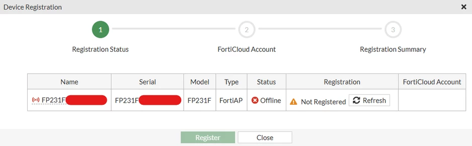

Trying to register a FortiAP/FortiSwitch through the FortiGate, the Register button is grayed out/inactive. Possible causes:
  • Inactive devices: If the list of devices to be registered includes one or more inactive devices (i.e., red status; not connected to the FortiGate), then the Register button is expected to be grayed out.
Go back to the Managed FortiAP or Managed FortiSwitches page and remove the inactive entries from the selection, then retry the registration process. It is only possible to register devices using the FortiGate that are actively connected for management.

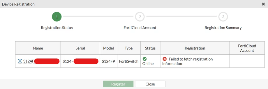

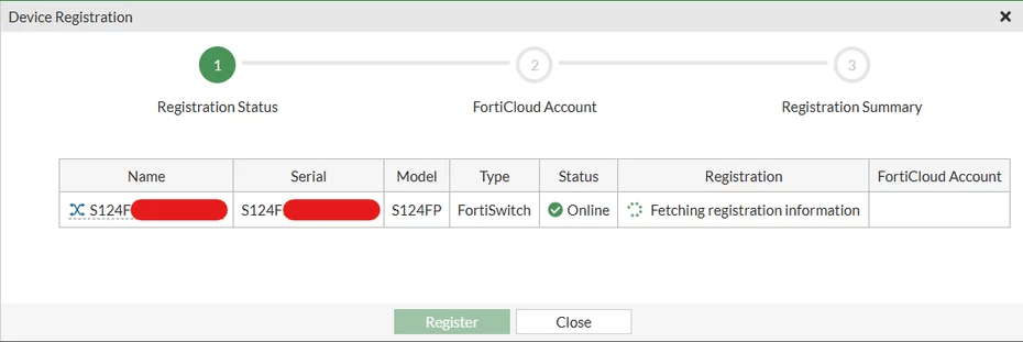

  • Registration is stuck due to a connectivity problem: If the Registration field states 'Fetching registration information' for a long period, followed by 'Failed to fetch registration information', as shown here:
Refer to the following article: How to fix 'Failed to fetch registration information' error when trying to register FortiSwitch/FortiAP to FortiCloud from FortiGate.

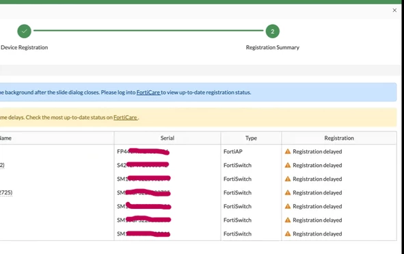

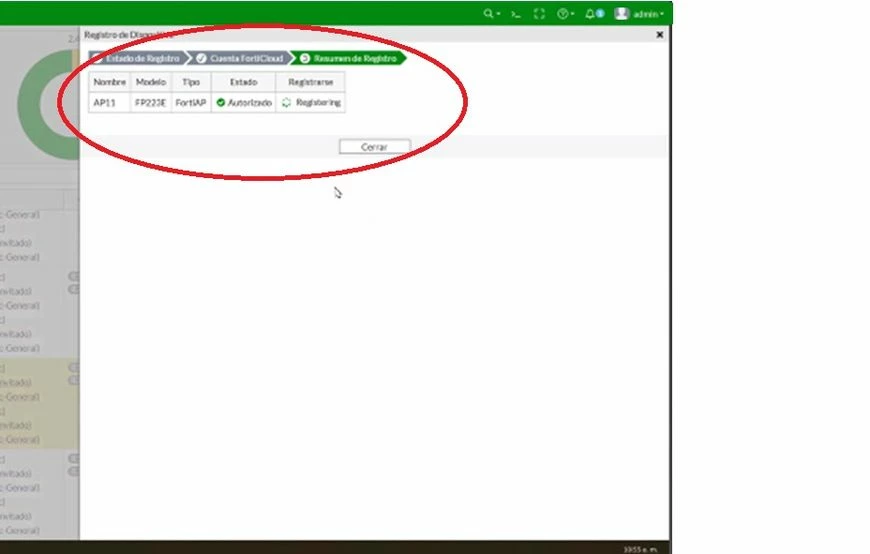

Solved the problem, the registration procedure via GUI should work, arriving at the last related page:
Note: In some situations, registration from the GUI is not possible, and it does not show a correct registration status. Use CLI commands to verify and complete registration.

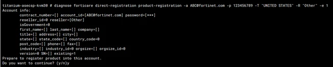

To register a FortiGate is necessary to execute:
diagnose forticare direct-registration product-registration -a <FortiCloud username> -p <password> -T <country> -R <reseller> -e 1
Example:
diagnose forticare direct-registration product-registration -a ABC@fortinet.com -p 123456789 -T "UNITED STATES" -R "Other" -e 1
To register FortiSwitch/FortiAP:
diagnose forticare direct-registration product-registration -N <FortiSwitch/AP Serial Num.> -a <FortiCloud username> -p <password> -T <country> -R <reseller> -e 1
Example:
diagnose forticare direct-registration product-registration -N S424FF111111112 -a ABC@fortinet.com -p 123456789 -T "UNITED STATES" -R "Other" -e 1
