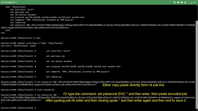

        set psksecret ENC  "
cKEiJTnk9PJH1fNS9j7BDqFqUmgiLT4EOqqzJKRlrhMIVnTdYvHmqZHRaRM3p1sz/BjYqCLv0YEZplWjECN6HvzOE2jwY1JU0IPRcFGRkmE2yvMrjltUQEThZNPq73Q9wMOT+vM/M0eW6
3wEQj/wqpgatsXrRnBxhniXcDp6LssBLsq9MlvwYb3rhAEl7puEOdwYzw==
For the PSK part, follow the instructions shown in the screenshot below to paste it:

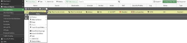

After, clone/copy the firewall policies for the tunnel and change the tunnel interface to a new tunnel.
CLI:
config firewall policy
clone 1 to 3
clone 2 to 4
After, change the IPsec tunnel interface from the GUI or just paste the copied firewall policy with a modified IPsec tunnel:

GUI:
 Clone method

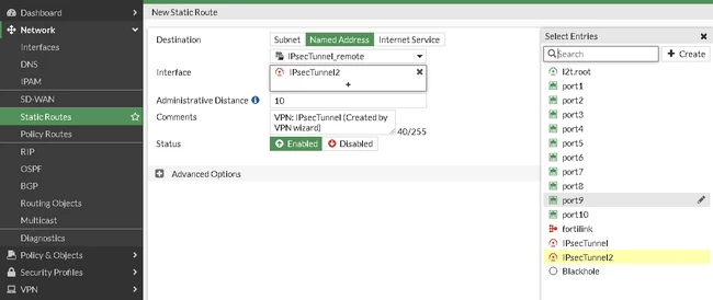

Similarly, clone or copy the static route and set the interface to the new Tunnel interface.
CLI:
config router static
    edit 3
        set device "IPsecTunnel2"                               <- Change the Tunnel name.
        set dstaddr "IPsecTunnel_remote"
GUI:
