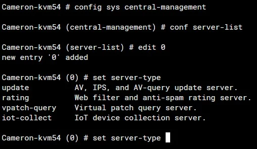

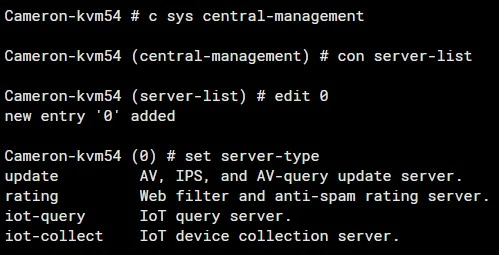

Before v7.4.8 and v7.6.0, the server-type setting in the server list of central-management is iot-query.
Starting from FortiOS v7.4.8 and 7.6.0,  the server-type setting's iot-query has been renamed to vpatch-query.
