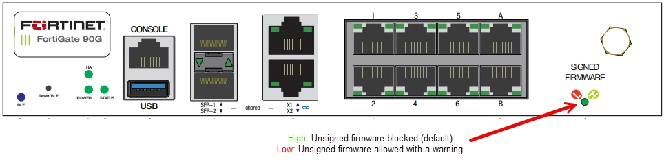

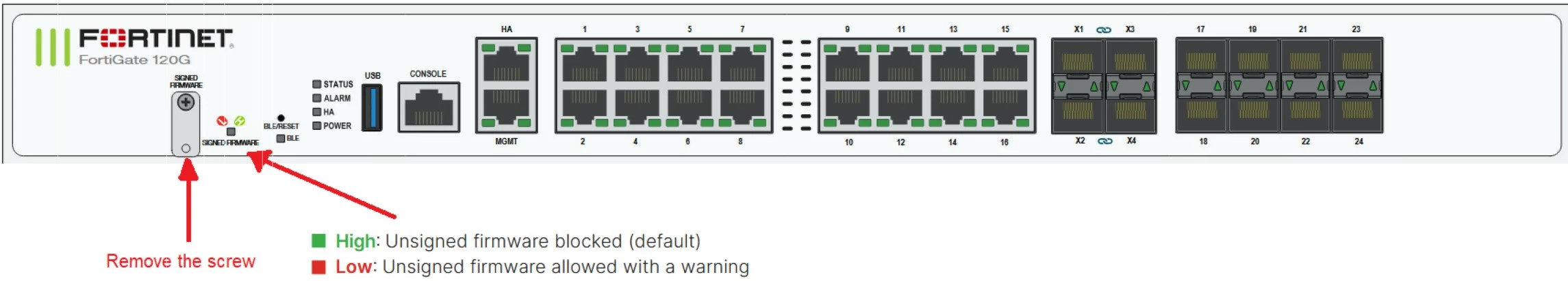

To summarize the locations of the security level switches (labelled as 'Signed Firmware'):
  • For the FortiGate 50G, 70G, and 90G (Gen 2 and later only), the switch is located on the rear panel of the appliance (opposite side to the status LEDs).
  • For the FortiGate 120G (Gen 2 and later only), 200G, and 700G, the switch is located on the front panel of the appliance.
For more information on the location of the Signed Firmware switch, consult the Quick Start Guides (QSGs) for the specific FortiGate model being worked on, available generally in the Hardware Guide section of the Fortinet Document Library:

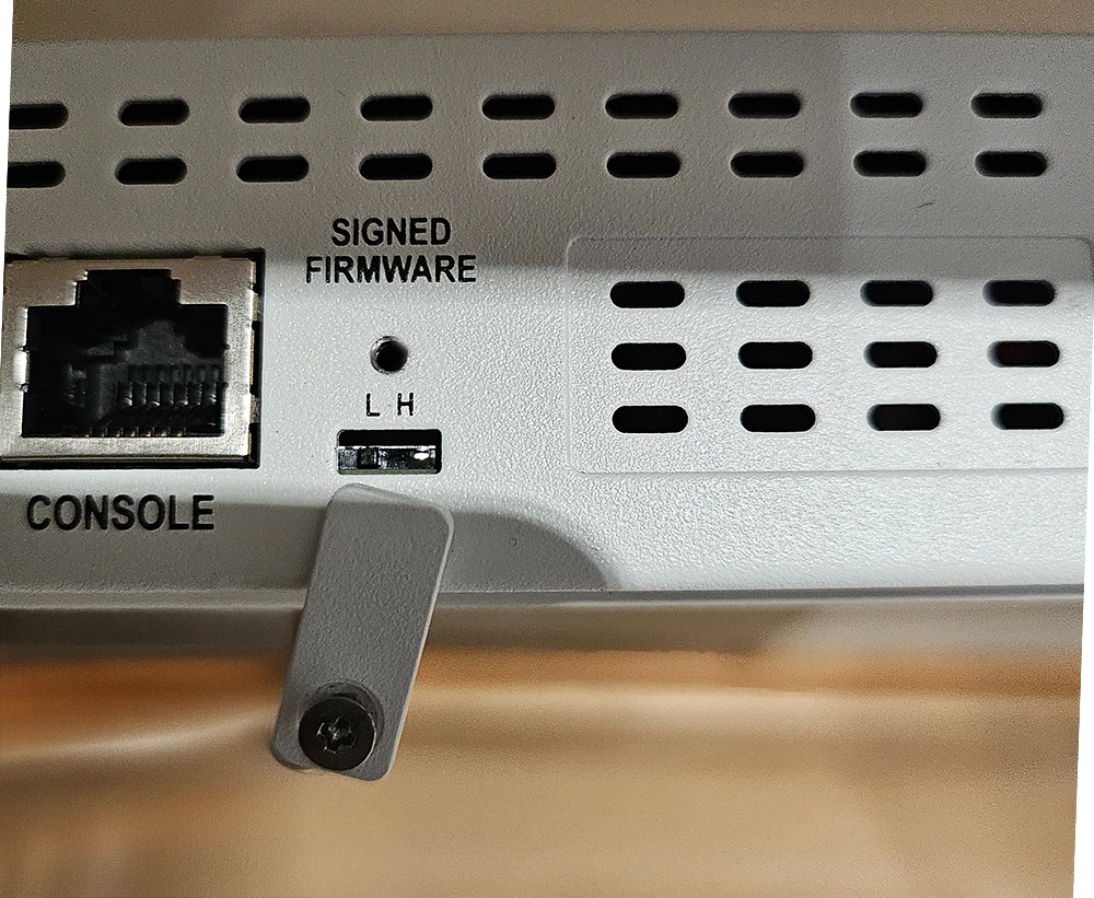

To access the switch, remove/loosen the screw that secures the metal cover to the FortiGate's casing, then change the switch to either High or Low:
  • High â€“ Unsigned firmware is blocked (default, typically the right-most position for the switch).
  • Low â€“ Unsigned firmware is allowed with a warning (typically the leftmost and/or middle position, depending on the switch being two- or three-position).
When the value of the switch is adjusted, the BIOS security value will not update until the FortiGate is next rebooted. The command get system status can be used to verify the current BIOS security level against the physical switch security level setting.
For example, the FortiGate 50G, 70G, and 90G Gen2 series have the signed firmware cover on the back of the appliance (opposite to the panel with the system LEDs). When the screw is removed from the Signed Firmware panel, a switch will be revealed that can be set to Low [L] or High [H]. The following screenshots show a FortiGate-50G:
On the front of the unit are the system LEDs, and the 'Signed Firmware' LED will also indicate the current security mode (red being Low, green being High). The following image shows the LED on a FortiGate 70G as an example:

For comparison, the FortiGate 200G and 700G series place the Signed Firmware switch and LED together on the front of the appliance:
Note regarding multi-generation hardware:
As noted in the corresponding QuickStart guide, the FortiGate 90G has several different generations. The Gen 2 models (identified with Part Numbers Pxxxxx-11-01 and above) include the Signed Firmware switch on the rear of the appliance and the system LED on the front, whereas older Gen 1 models (Pxxxxx-10-01 and below) do not.
Similarly, the FortiGate 120G series also has multiple generations, with Gen 2 models (Part Numbers Pxxxxx-2x-01 and above) including the Signed Firmware switch and system LED both on the front of the appliance, and older Gen 1 models (Pxxxxx-19-01 and below) not having these features.
