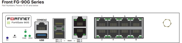

FortiGate-90G Gen1 devices use part numbers Pxxxxx-10-01 and lower, while Gen2 devices use part numbers Pxxxxx-11-01 and higher (for additional details, refer to the FortiGate 90G QuickStart Guide).

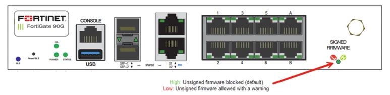

The front panel of the 90G (Gen2) models includes an LED that shows whether the device is operating in security mode L or H.

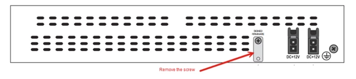

The signed-firmware panel is positioned on the back of the device and becomes accessible once the screw is removed, allowing the switch to be used to select either Low [L] or High [H] security mode.
When the switch is changed from High (default) to Low, a log entry is generated with the following ID:
22906 - LOG_ID_SECURITY_LEVEL_CHANGE
After changing the switch position, the BIOS security level will only update after the FortiGate is rebooted. The command get system status can be used to view both the active BIOS security level and the current setting of the physical security-mode switch.
