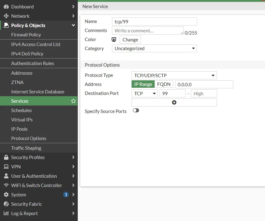

  1. Go to Policy & Objects -> Services and create a new service that includes the ports to be blocked. It is possible to use a range (e.g. 99-199) in a single service. If multiple ports in different ranges should be blocked, make a new service for each port and instead put them into a single Service Group.

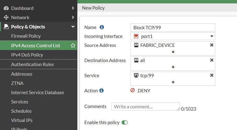

  1. Go to Policy & Objects -> IPv4 Access Control List and create a new ACL that references the Service / Service group created in step 1. Configure the ACL to block traffic from all sources to the specified destination IP address and ports, with the correct interface.
The FortiGate CPU handles local-in policies and does not offload them to the Network Processing Unit (NPU). However, ACLs can be offloaded to the NPU7, which can help reduce CPU usage.
