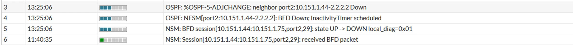

Sample of FortiGate router log:

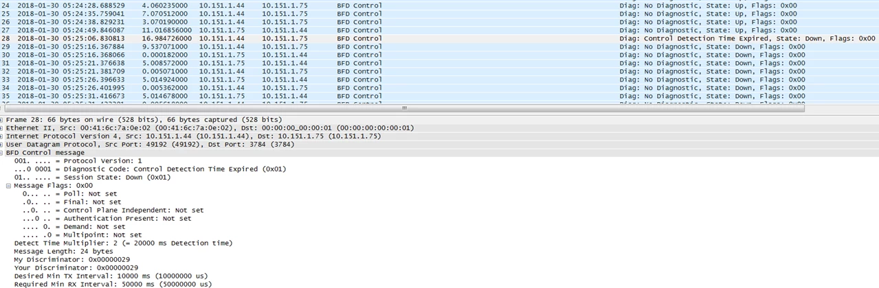

To sniff BFD packets:
diagnose sniffer packet any "udp port 3784" 6 0 a
Sample BFD packets seen with packet decoder:
