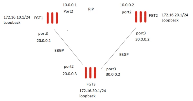

Diagram:

  1. Network 172.16.20.0/24 is learned via two different routing protocols i.e., BGP and RIP.
    The network learned via BGP is installed in the routing table because of the lower distance and the network learned via RIP is installed in the database.
