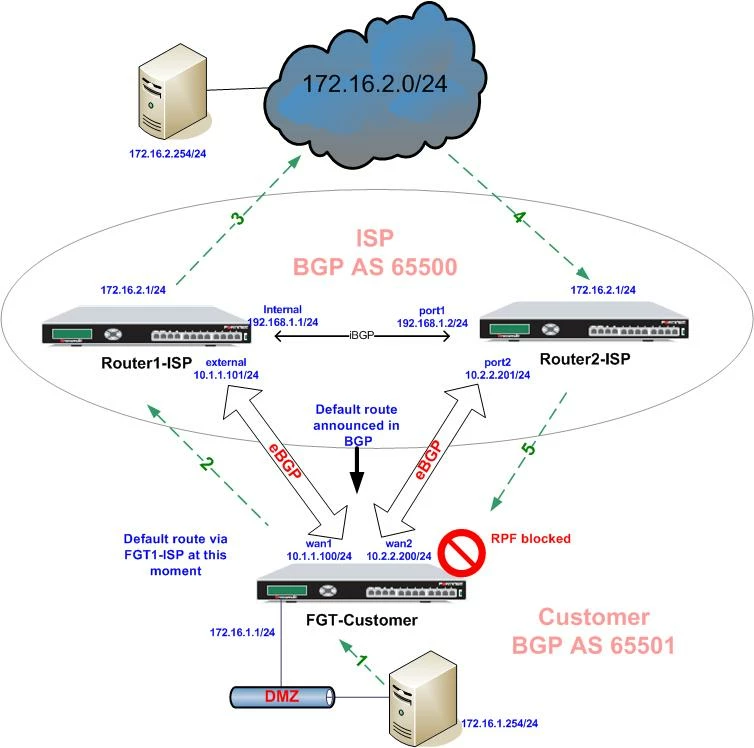

The base scenario with asymmetric routing is the following :
The green arrows show the traffic flow from 172.16.1.254 to 172.16.2.254. At step 5, the return traffic is ingressing on wan2, but the FGT-Customer has got no default route (or simply no specific route) to 172.16.2.254 via wan2, and will therefore drop the traffic due to RPF (reverse past forwarding) check.
See the current routing table of FGT-Customer:
FGT-Customer # get router info routing-table all
B* 0.0.0.0/0 [20/0] via 10.1.1.101, wan1, 00:25:03
C 10.1.1.0/24 is directly connected, wan1
C 10.2.2.0/24 is directly connected, wan2
C 10.160.0.0/23 is directly connected, internal
C 172.16.1.0/24 is directly connected, dmz
And the echo replies ingressing wan2 but not forwarded to the source on DMZ :
FGT-Customer # diagnose sniffer packet any "host 172.16.2.254" 4
1.612126 dmz in 172.16.1.254 -> 172.16.2.254: icmp: echo request
1.612170 wan1 out 172.16.1.254 -> 172.16.2.254: icmp: echo request
1.615987 wan2 in 172.16.2.254 -> 172.16.1.254: icmp: echo reply
2.616253 dmz in 172.16.1.254 -> 172.16.2.254: icmp: echo request
2.616317 wan1 out 172.16.1.254 -> 172.16.2.254: icmp: echo request
2.616987 wan2 in 172.16.2.254 -> 172.16.1.254: icmp: echo reply

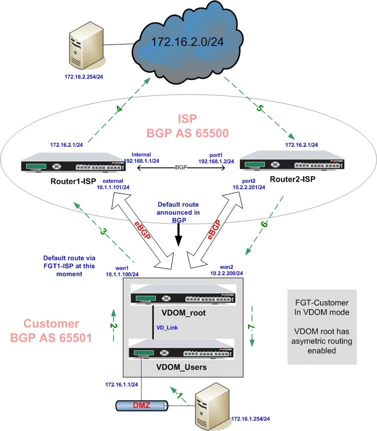

One solution presented here is dedicating a 'routing' VDOM on which asymmetric routing will be enabled.
Let's assume this VDOM will be the default 'root' VDOM, and the VDOM to the internal or user traffic will be named VDOM_Users.
Both VDOMs are interconnected via an unnumbered inter-VDOM link.
The final configuration of FGT_Customer is attached to this article.
There is now the following diagram in VDOM mode :
This is the new global setting for the interfaces :

This is the new configuration specific to the 'root' VDOM :
config system settings
set asymroute enable
config router static
set device "VDOM_link0"
set dst 172.16.1.0 255.255.255.0
set weight 50
config firewall policy
set srcintf "VDOM_link0"
set dstintf "wan1"
set srcaddr "all"
set dstaddr "all"
set service "ANY"
set dstintf "wan2"
set srcaddr "all"
set dstaddr "all"
set service "ANY"
set weight 50
set dstintf "wan1"
set srcaddr "all"
set dstaddr "all"
set service "ANY"
set dstintf "wan2"
set srcaddr "all"
set dstaddr "all"
set service "ANY"
This is the new configuration specific to the 'VDOM_Users' VDOM :
set device "VDOM_link1"
set weight 50
set srcintf "dmz"
set dstintf "VDOM_link1"
set srcaddr "all"
set dstaddr "all"
set service "ANY"
set weight 50
set srcintf "dmz"
set srcaddr "all"
set dstaddr "all"
set service "ANY"
Verification.
Verification with the default route pointing to router1 on the VDOM 'root':

And there is now the echo reply ingressing wan2 and forwarded to the source on the DMZ:
FGT-Customer (root) # diagnose sniffer packet any "host 172.16.2.254" 4
0.641377 dmz in 172.16.1.254 -> 172.16.2.254: icmp: echo request
0.641377 VDOM_link0 in 172.16.1.254 -> 172.16.2.254: icmp: echo request
0.641493 wan1 out 172.16.1.254 -> 172.16.2.254: icmp: echo request
0.642139 wan2 in 172.16.2.254 -> 172.16.1.254: icmp: echo reply
0.642139 VDOM_link1 in 172.16.2.254 -> 172.16.1.254: icmp: echo reply
0.642203 dmz out 172.16.2.254 -> 172.16.1.254: icmp: echo reply
