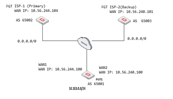

Diagram:
ISP-1 & ISP-2 FortiGates, are advertising only default route (0.0.0.0/0) to FortiGate1 (FGT1). With BGP “local-preference” attribute, default route learned from ISP-1 (Primary) is preferred over ISP-2(Backup). When ISP-1 link is down, default route is learned from ISP-2.
Expectations, Requirements
Customer wants to advertise a local network 10.163.0.0/24 behind FortiGate1 to active ISP only. If ISP-1 link (Primary) is active, then FortiGate must not advertise 10.163.0.0/24 to ISP-2.
It should advertise network 10.163.0.0/24 to ISP-2 only when it isn’t learning default route (0.0.0.0/0) from Primary ISP-1 (AS 65002). Scenario when ISP-1 has issues and is unreachable.
