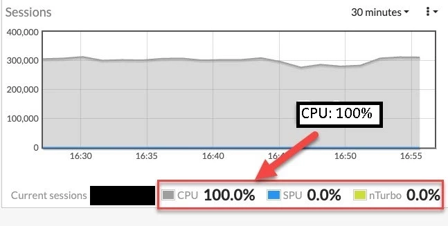

The issue with sFlow is that it disables hardware acceleration for traffic on the interfaces it was enabled on FortiGates with Network Processor (NP) acceleration chips. And then all the traffic is processed by the CPU and not by NP, in turn lowering the overall network performance.
In the below screenshot, it is possible to see that the CPU is 100% as all the traffic is passed by the CPU:
