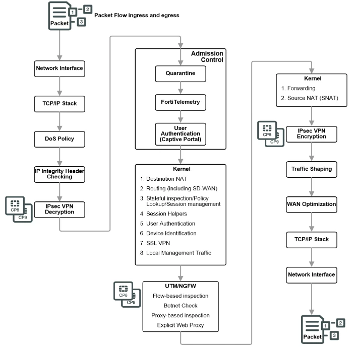

FW-01 lost the default route from the ISP. The client tries to access the 34.223.124.45 IP address via HTTP in the example below. The firewall receives the traffic and processes it based on the Parallel Path Processing logic:

According to the flow debug the firewall has allocated a new session and is attempting to find a route to the destination. As there is no route the debug flow will cease to produce any further output and the SYN packet will be silently dropped.
No allow or deny log will be generated as FortiGate never performed a policy lookup for an SYN packet since it could not pass route validation. This is the expected behavior.

Packet flow ingress and egress: FortiGates without network processor offloading
