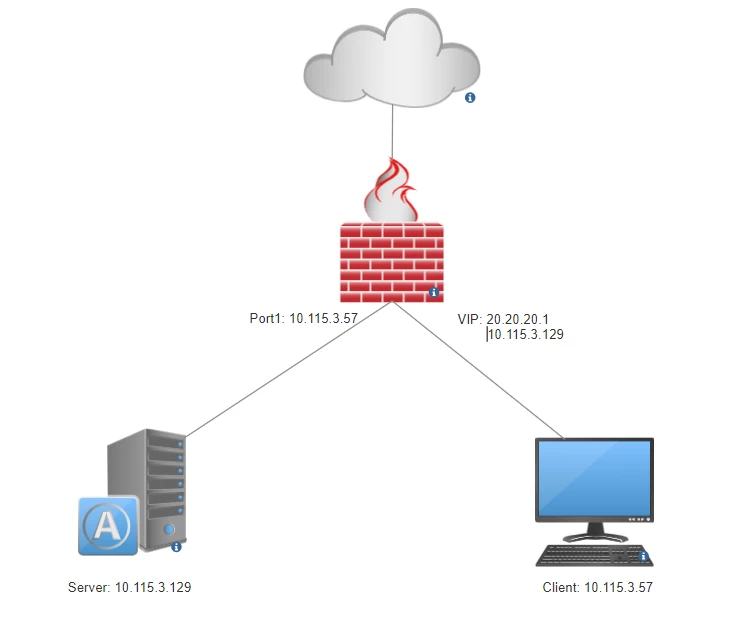

When a user behind the firewall would like to access the Server on public IP, which is also behind the same interface of the firewall, the NAT hairpin is used. The behavior of the NAT hairpin is different in cases where Central NAT is enabled on the firewall.
Consider an example where there is both a Client and a Server behind Port1 of the FortiGate firewall. The user would like to access the server over the public IP, so NAT Hairpin is used and a Port1 to Port1 policy is required to allow the traffic. Below is the IP scheme:
Port1: 10.115.3.57
Client: 10.115.3.125
Server: 10.115.3.129
VIP: 20.20.20.1  à 10.115.3.129
A TCP session from the client to the server over port 5201 is initiated. When this session starts, it hits policy 4, DNAT takes place, and, consistent with known NAT hairpin behavior, it will also SNAT the outgoing traffic even if there is no Central NAT policy configured for this traffic. Below is the session and debug flow output:
