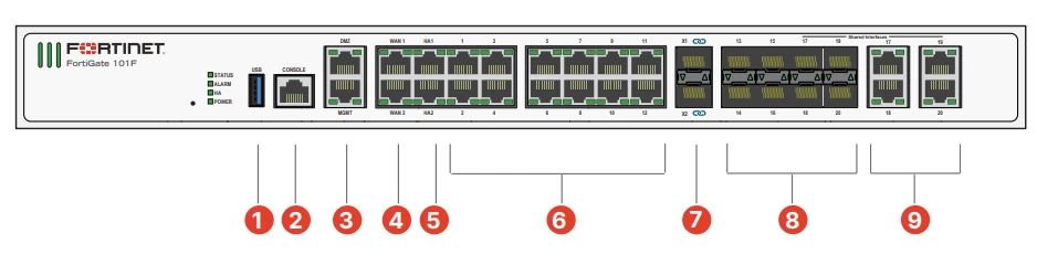

For example, in the below FortiGate 101F, ports 17-20 are designated as Shared Media Interface:

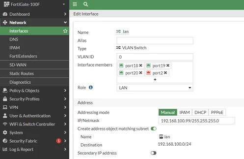

Ports 18-20 are part of the hardware switch along with port 2, which is down:
When port 2 is removed from the 'lan' switch interface, the system event indicates that the 'lan' interface has gone down and back up. This behavior will also occur when port 2 is added back. If any VLAN interfaces or overlay services are configured on top of the hardware switch, they will also experience a brief disruption during the change.

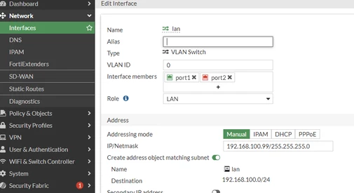

Conversely, if ports 1 and 2 are included in the hardware switch, and port 1 is up, removing port 2 will not cause a flap since port 1 is not a Shared Media Interface.
