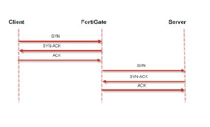

This means that two distinct connections are created.
Client to FortiGate.
FortiGate to the server.

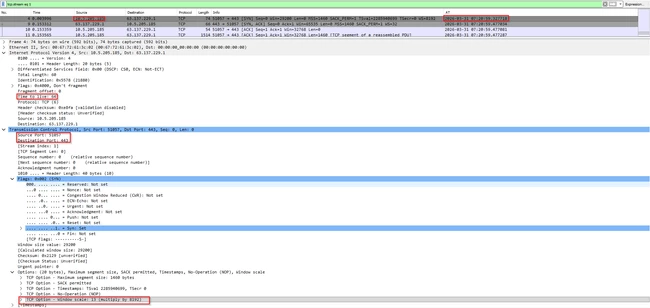

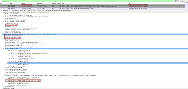

The following snapshots were taken for the connection between the client and the FortiGate and the FortiGate to the server.
Client to FortiGate:
FortiGate to the server:
The highlighted parameters facilitate troubleshooting.
The above output shows two connections, which include the client to the firewall and the firewall to the server.
This information is helpful when the TCP handshake is successful in Wireshark, but the website does not work (there may be no TCP handshake completing on the FortiGate -> Server session).
