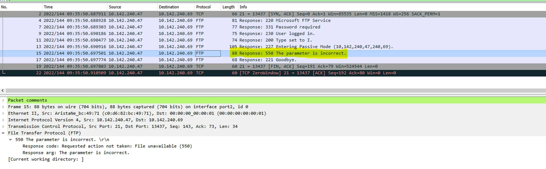

If there is any connectivity issue or typo in the interpretation of the CLI command, the error 'Send config file to FTP server via VDOM root failed can be seen.
Collect the sniffer output with the FTP server IP and port as a filter. Clarify where the issue is:

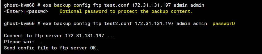

A situation may arise where entering the command will lead to the console instead of successfully connecting to the FTP server:
This usually arises when the password has symbols that are not interpreted correctly. A good practice is to put it under quotes for the firewall to take the password successfully:
The command to perform the encrypted backup-up configuration is as below:
execute backup config ftp filename server-address ftp-username ftp-password config-password
<config-password> Password to protect the back-up file
The configuration is backed up on the FTP server-specified directory with the name test.conf.
