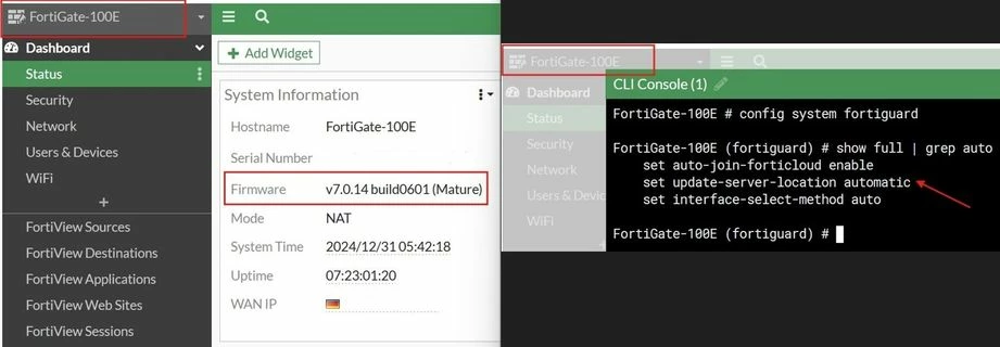

The behavior in the CLI is as follows:
FortiGate-100E # config system fortiguard
FortiGate-100E (fortiguard) # show full | grep auto
set auto-join-forticloud enable
set update-server-location automatic <----- set auto-firmware-upgrade enabled/disabled is missing.

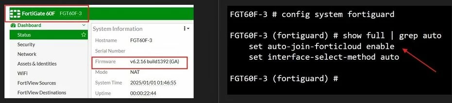

FortiGate-60F with v6.2.16:
FortiGate-100E with v7.0.14:

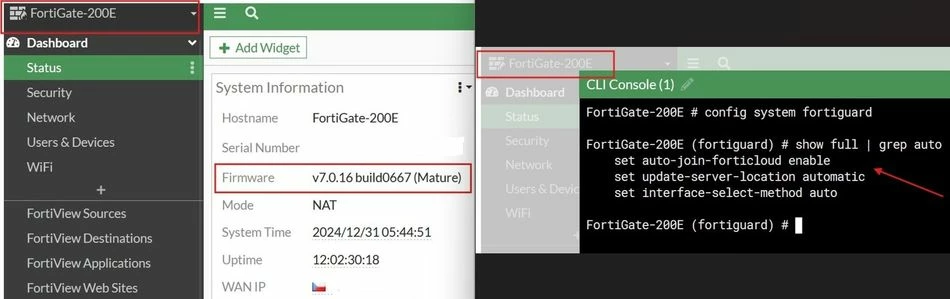

FortiGate-200E with v7.0.16:

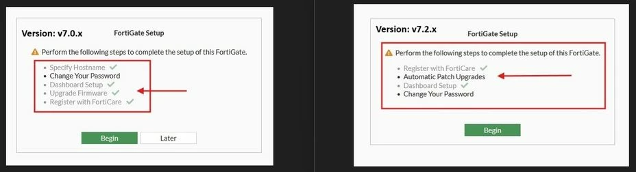

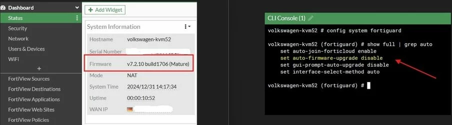

To get this feature: automatic patch-level firmware upgrade. The FortiGate needs to be upgraded to v7.2.x and higher. (attachment below).
