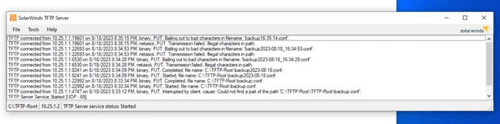

Note 3:
%%time%% or %%log.time%% not working for some of the TFTP/SFTP/FTP servers as it analyzed as bad characters for the title.
Here is the output:
Note 4:
To check if the backup configuration is working with variables (date/ time) needs to be done using automation stitch only and does not change the variables if checking from CLI console or SSH.
Due to Windows limitations, the Windows FTP server will not allow file saves with ':' in them for automation stitch with variable date and time, therefore it will only save the configuration file name with variable date.
