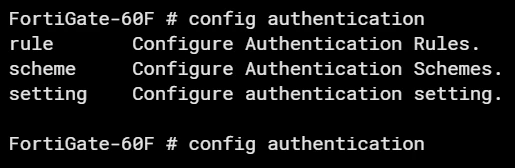

Description This article describes the authentication feature missing after firmware upgrade to v7.4.10 and above for FortiGate hardware with 2 GB RAM.
Scope FortiGate v7.4.10 and above.
For FortiGate hardware with 2GB RAM and running firmware v7.4.9 and below, 'config authentication scheme' and config authentication rule still exist in FortiOS.
After upgrading to v7.4.10 and above, both commands are missing.
This is expected behavior because the authentication feature was removed from firmware v7.4.10.
