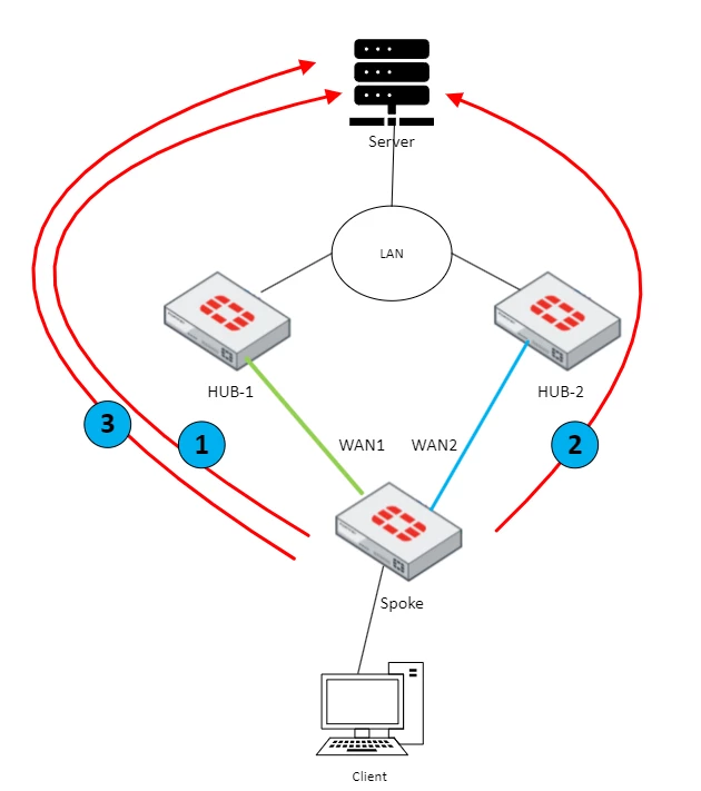

In a scenario with SD-WAN and dual-hub, the options 'set anti-replay disable' and 'set tcp-session-without-syn all' are very useful.
They work together very well; for example, there is an SLA change that affects the session.
In the diagram below, there is a spoke connected to two HUBs via WAN1 and WAN2. The client established a TCP session with the server behind the HUBs.
Initially, the session is created via WAN1 and allowed on HUB1(arrow No. 1). If, for some reason, the SLA changes, then the spoke will start to use the better route via WAN2 (arrow No. 2). If the 'set tcp-session-without-syn' is not enabled, then HUB2 will block the incoming packets hence the session fail and timeout.
If it is enabled, then will it allow the session to be created without a new 3-way handshake, once the SLA recovers and the spoke switches back to WAN1(arrow No3), then HUB1 will drop the session/packets if the 'set anti-replay' is enabled.
Both options should be configured on HUB1 and HUB2; the reason is that the active TCP session from the spoke could switch to the better-performing member.
