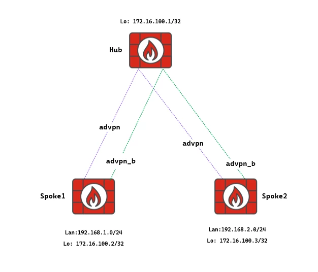

The topology used in this example is simple. Single HUB with 2 Spokes, each device has a Loopback with a unique IP address that is used to establish BGP and for routing between Spokes. Each Spoke has 2 connections to the HUB.

Network 172.16.100.0/24 is the whole Loopback subnet for HUB and all Spokes. HUB will need to distribute this network because Spoke will use this network for next-hop resolution. Either it is possible to create a static route for this network via VPN interfaces, or if the subnet is not in the routing table, network-import-check needs to be disabled.

But when the shortcut is created, the difference will be visible:
Spoke1 # get router info routing-table all
Codes: K - kernel, C - connected, S - static, R - RIP, B - BGP
O - OSPF, IA - OSPF inter area
N1 - OSPF NSSA external type 1, N2 - OSPF NSSA external type 2
E1 - OSPF external type 1, E2 - OSPF external type 2
i - IS-IS, L1 - IS-IS level-1, L2 - IS-IS level-2, ia - IS-IS inter area
V - BGP VPNv4
* - candidate default
Routing table for VRF=0
S* 0.0.0.0/0 [10/0] via 10.0.0.254, port10, [1/0]
C 10.0.0.0/24 is directly connected, port10
C 20.0.0.0/24 is directly connected, port1
C 30.0.0.0/24 is directly connected, port3
B 172.16.100.0/24 [200/0] via 172.16.100.1 (recursive via advpn tunnel 20.0.0.1), 00:52:10
(recursive via advpn_b tunnel 30.0.0.1), 00:52:10, [1/0]
S 172.16.100.1/32 [15/0] via advpn tunnel 20.0.0.1, [1/0]
[15/0] via advpn_b tunnel 30.0.0.1, [1/0]
C 172.16.100.2/32 is directly connected, Loopback
S 172.16.100.3/32 [15/0] via advpn_0 tunnel 20.0.0.3, [1/0]
C 192.168.1.0/24 is directly connected, port2
B 192.168.2.0/24 [200/0] via 172.16.100.3 (recursive via advpn_0 tunnel 20.0.0.3), 00:01:58, [1/0]
As shown in the example, the second route towards 192.168.2.0/24 via the backup tunnel is missing. Because of that, traffic will be forced to egress the advpn_0 shortcut even if it is out of SLA until the tunnel is flushed.
Use the loopback as the source interface, as the loopback is always up and stable. The loopback is down when the device is down.
Advertise this loopback in the BGP network, in case using an IGP protocol like OSPF or ISIS should have reachability.
In case of ADVPN and SD-WAN with loopback, avoid using a remote BGP peer (which is loopback) for health-check under SD-WAN. Use a different IP for health-check instead of the BGP remote peer. The reason is that a kernel route for the health-check server IP will be created and will not be removed even when the health check fails. This will cause the spoke to continue sending BGP traffic over the same VPN tunnel even if it is down.
