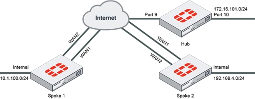

This article describes how to configure ADVPN with BGP.
FortiGate v6.4.3 and v7.0.1+.
Below is an example configuration of ADVPN with BGP as the routing protocol. The following options must be enabled for this configuration:
  1. On the hub FortiGate, the IPsec command 'phase1-interface net-device disable' must have been run.
  2. IBGP must be used between the hub and spoke FortiGate.
  3. 'bgp neighbor-group/neighbor-range' must be reused.
Because the GUI can only complete part of the configuration, it is recommended to use the CLI. To configure ADVPN with BGP as the routing protocol using the CLI:
  1. Configure the hub FortiGate's WAN, internal interface, and static route.
