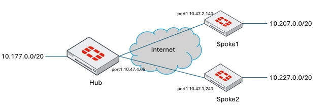

The topology in this example is ADVPN Hub and Spokes as per the above diagram.
  • Port1 is the WAN link for all devices.
  • 10.10.1.0/24 is used for the ADVPN topology. Hub will assign 10.10.1.x to spokes.
  • BGP is the routing protocol.
  • 10.177.0.0/20 (lan-hub) is the local network behind the Hub. 10.207.0.0/22 (spoke1-lan) and 10.227.0.0/20(spoke2-lan) are local networks behind spokes.
