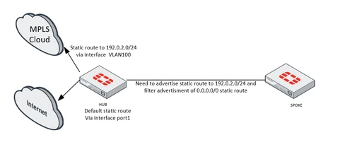

In this setup, there are two units involved the HUB and the SPOKE.
On the hub there are two static routes:
192.0.2.0/24 via the MPLS network
0.0.0.0/0 via port1 (INTERNET)
Between the hub and the spoke BGP is running.
BGP is already configured, and peering is UP.
