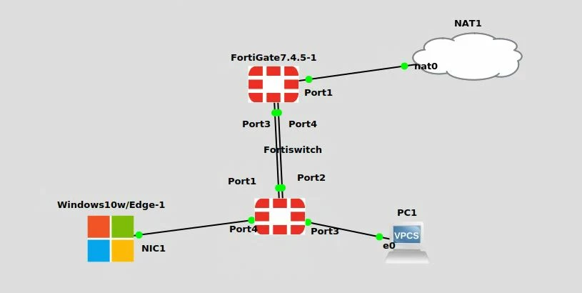

In the example setup:
  • Windows 10 w/Edge-1 (Windows 10 client) and PC1 are both connected to VLAN 10 (named user_vlan10).
  • VLAN 10 is assigned the IP subnet 192.168.10.0/24.
  • The default gateway for VLAN 10 is 192.168.10.1, which is configured on the FortiGate.
Network Topology:
Diagram Details:
  • FortiGate connects to a FortiSwitch over Ports 3 and 4.
  • FortiSwitch provides Layer 2 connectivity.
  • Windows10w/Edge-1 connects via NIC1 using 192.168.10.2
  • PC1 connects via the e0 interface and is assigned 192.168.10.3
  • FortiGate is connected to the internet over Port 1.
In this topology, blocking intra-VLAN traffic ensures that Windows 10 and PC1 cannot communicate directly at the Layer 2 level, even though they are in the same VLAN and subnet.

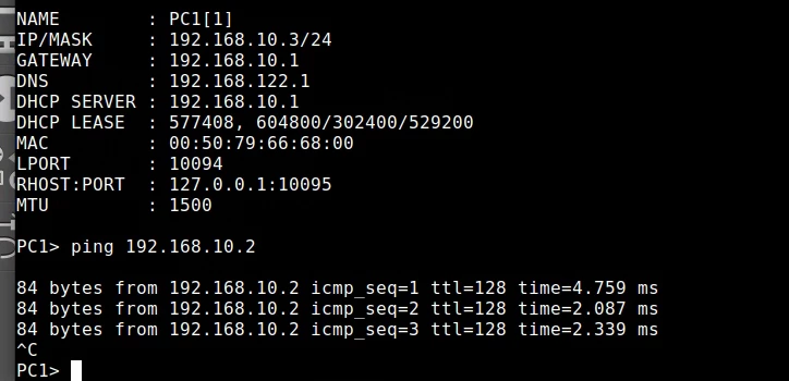

Before the setting is enabled. Pinging across the two hosts in the same VLAN:

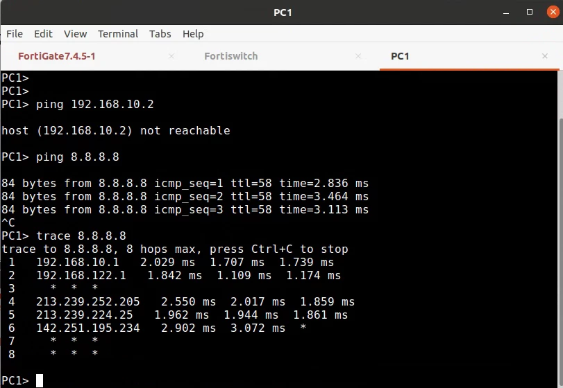

Blocking intravlan Setting is enabled:
Testing and Behaviour:
  • Ping between devices fails.
  • Devices retain Internet access and reachability to the FortiGate.
