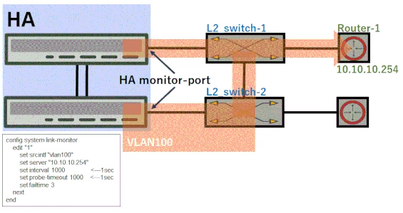

For example, a link-monitor has been configured on HA as follows:
In this situation, if Router-1 goes down, the link-monitor failure will be detected by 4 seconds.
  • Time = 'interval' * 'failtime' + 'probe-timeout'
  • Time = 1 * 3 + 1 = 4 seconds

If L2_switch-1 goes down then HA failover occurs, and the link-monitor failure is detected by 14 seconds.
  • Time = 'interval' * 'failtime' + 'probe-timeout' + 'lnkmtd cold start'
  • Time = 1 * 3 + 1 + 10 = 14 seconds
