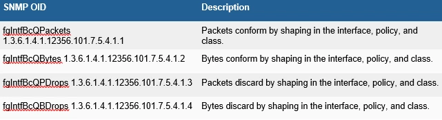

Four SNMP OIDs have been added for polling the number of packets and bytes that either conform or discard by traffic shaping.
This article describes how to add SNMP OIDs for shaping-related statistics.

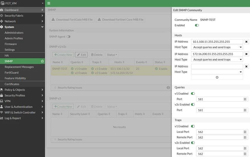

1) Configure SNMP:
# config system snmp community
        set name "SNMP-TEST"
        # config hosts
                set ip 10.1.100.11 255.255.255.255
                set ip 172.16.200.55 255.255.255.255
        # config hosts6
                set ipv6 2000:172:16:200::55/128
                set ipv6 2000:10:1:100::11/128
        set events cpu-high mem-low log-full intf-ip vpn-tun-up vpn-tun-down ha-switch ha-hb-failure ips-signature ips-anomaly av-virus av-oversize av-pattern av-fragmented fm-if-change fm-conf-change ha-member-up ha-member-down ent-conf-change av-conserve av-bypass av-oversize-passed av-oversize-blocked ips-pkg-update faz-disconnect
To configure from GUI, go to System -> SNMP.

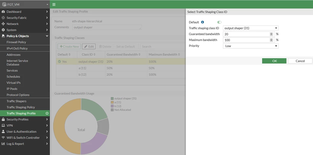

2) Configure the traffic shaping profile:
# config firewall shaping-profile
    edit "eth-shape-hierarchical"
        set comment "output shaper"
        set type queuing
        set default-class-id 31
        # config shaping-entries
            edit 31
                set class-id 31
                set priority low
                set guaranteed-bandwidth-percentage 20
                set maximum-bandwidth-percentage 100
            edit 11
                set class-id 11
                set priority top
                set guaranteed-bandwidth-percentage 50
                set maximum-bandwidth-percentage 50
                set limit 5
            edit 12
                set class-id 12
                set priority critical
                set red-probability 10
                set min 5
                set max 10
To configure from GUI, go to Policy & Object -> Traffic Shaping Profile and select 'Create New'.

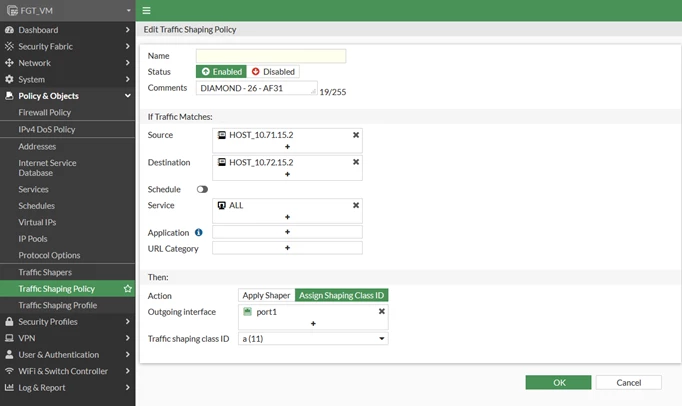

3) Configure the traffic shaping policy:
# config firewall shaping-policy
    edit 11
        set comment "DIAMOND - 26 - AF31"
        set service "ALL"
        set dstintf "port1"
        set class-id 11
        set diffserv-forward enable
        set srcaddr "HOST_10.71.15.2"
        set dstaddr "HOST_10.72.15.2"
        set diffservcode-forward 011010
    edit 25
        set comment "GOLD - 20 - AF22"
        set service "ALL"
        set dstintf "port1"
        set class-id 12
        set srcaddr "HOST_10.71.15.3"
        set dstaddr "HOST_10.72.15.3"
        set diffservcode-forward 010100
To configure from GUI, go to Policy & Object -> Traffic Shaping Policy and select 'Create New'.

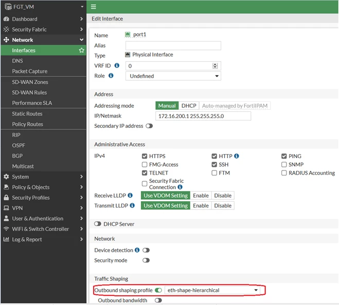

5) Configure the interface:
# config system interface
    edit "port1"
        set vdom "root"
        set ip 172.16.200.1 255.255.255.0
        set allowaccess ping https ssh http telnet
        set type physical
        set egress-shaping-profile "eth-shape-hierarchical"
        set snmp-index 1
To configure from GUI, go to Network -> Interfaces, select 'WAN interface', select 'Edit' -> Traffic shaping, to enable the 'Outbound shaping profile'.
