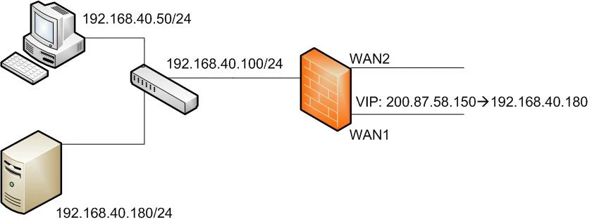

This article describes how to access to an internal server via WAN2 port.
Diagram
Expectations, Requirements
User 192.168.40.50 should be able to access to the internal server 192.168.40.180 via public IP address 200.87.58.150 on WAN1 interface.

3) PC and Internal Server are located in same LAN segment.
# config router policy
        set dst 192.168.40.180/32
        set src 192.168.40.0/24
        set input-device lan
        set output-device lan
