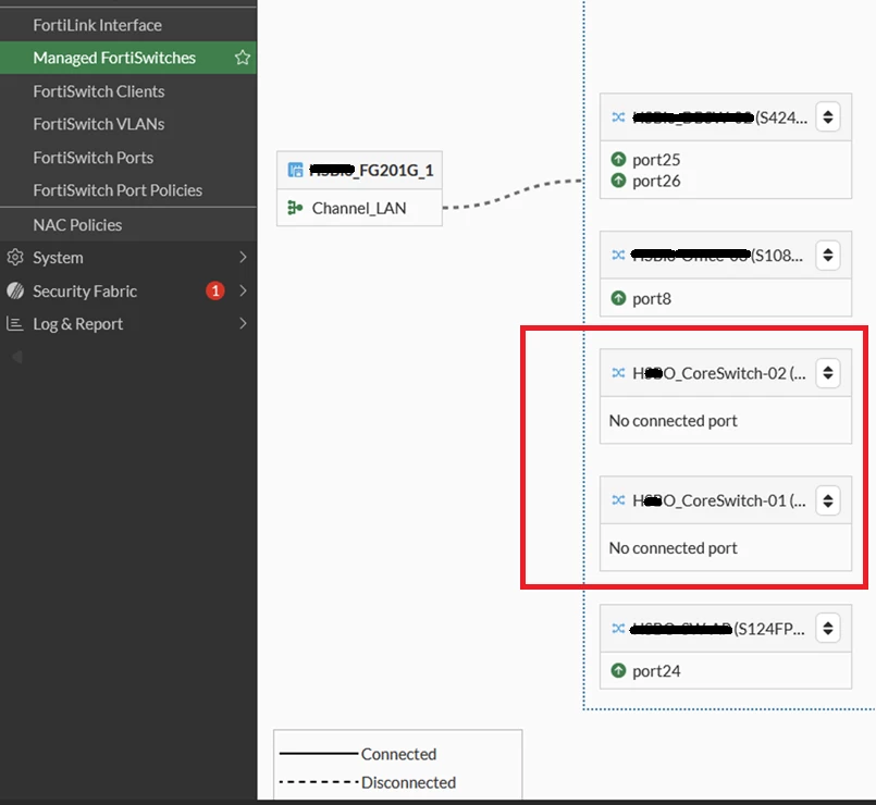

This article describes a topology issue where the FortiLink connection between the FortiGate and the FortiSwitch units is not being displayed. The user is managing these FortiSwitches via FortiGate in a specific configuration, but the FortiLink connection is not shown.
For example, there is no link in the topology of Firewall FG201G_1 and Switches HXXO_CoreSwitch-01 and HXXO_CoreSwitch-02.
Scope FortiGate, FortiSwitch, FortiLink.

  1. It shows that the names of HXXO_CoreSwitch-01 and HXXO_CoreSwitch-02 exceeded 16 characters, causing the display issue in the network topology.
HXXO_CoreSwitch-02 v7.6.6 (1137) Authorized/Up 2 10.X.X.252 Sun Jan 25 11:13:53 2026 S648...36
HXXO_CoreSwitch-01 v7.6.6 (1137) Authorized/Up 2 10.X.X.253 Sun Jan 25 11:13:45 2026 S648...77
2026-02-12 09:02:38 switch-id : [HXXO_CoreSwitch-]
--> Exceeded 16 characters.
2026-02-12 09:02:38 serial-num : [S648F...36]
2026-02-12 09:02:38 uplink : [Channel_LAN]
2026-02-12 09:02:38 serial-num : [S648...77]
