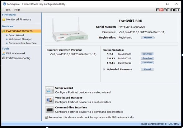

1. Make sure the FortiGate is listed under the FortiExplorer before proceeding further.

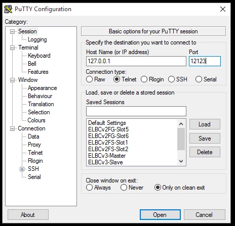

2. Open any native Telnet application like "Putty" or "Tera Term".
3. On the host field enter the following IP address "127.0.0.1"; this is a local host IP address.
4. On the Port use 12123.

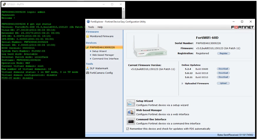

5. Connect to the FortiGate and a login prompt will be displayed.
6. Login as usual and enable logging if required.
Note: there is no network connection from the PC to the FortiGate; the only connection from the PC is a USB connection from the PC to the USB Management port of the FortiGate.

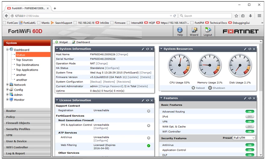

HTTP default port = 80 will become 12180
Any browser can be used to access the FortiGate leveraging on the FortiExplorer:
