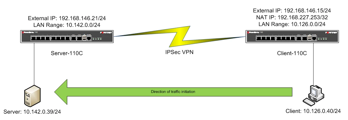

This article provides an example of configuring a FortiGate unit for uni-directional traffic with NAT IP via IPSec VPN.
This solution will be useful for users with multiple devices/machines behind a FortiGate unit "A" and would like the devices/machines behind FortiGate unit "B" to only see a single IP address.
Assumptions:
1. Traffic directions will only be from Client -> Server and NOT vice versa
2. All the traffic originating from the Client will be NATed to a single IP ~ 192.168.227.253/32
3. IPSec VPN set up in Tunnel Mode (Policy-based VPN)
