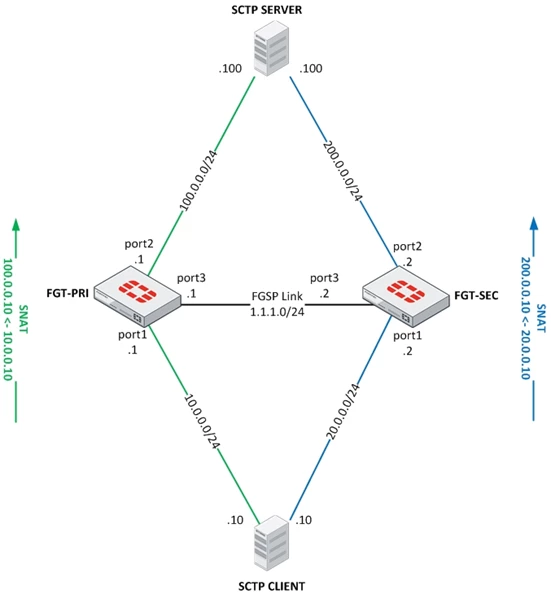

This article describes how to configure SCTP source NAT in a multihoming environment.
Diagram
Expectations, Requirements
- primary path (green) : 100.0.0.10
- secondary path (blue) : 200.0.0.10
- FGSP is configured in order to synchronize the sessions between the FortiGate.
Configuration
In this setup the INIT / INIT_ACK messages are sent over the primary path only. The primary FortiGate will then sync the sessions and the session expectations to the Secondary FortiGate.
The following HA configuration is required (FGSP configuration is out of the scope of this article):
- SNAT for the primary path:
The SNAT is applied according to IP pool configuration.
- SNAT for the secondary path:
The SNAT is applied according to IP translation configuration. If no IP translation is configured for the secondary path, the source IP may be translated incorrectly.
Diagram
Expectations:
- The SCTP client has 2 separate paths (SCTP multihoming) through 2 Fortigates in FGSP.
- The client IP must be translated (SNAT) with the following IPs :- primary path (green) : 100.0.0.10
Configuration
The following configurations need to be applied:
