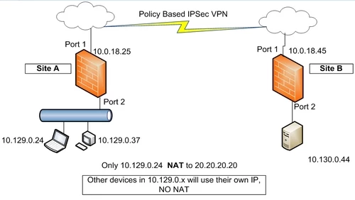

Topology
Site A Setup:
WAN IP : 10.0.18.25
LAN IP : 10.129.0.25/23
Local IP which should be Natted: 10.129.0.24 (with 20.20.20.20)

This scenario illustrates Policy Based VPN between 2 sites and explains how to Source NAT a specific IP in Site A before reaching Site B. The same logic can be used to Source NAT a whole subnet.
Topology
Site A Setup:
WAN IP : 10.0.18.25
