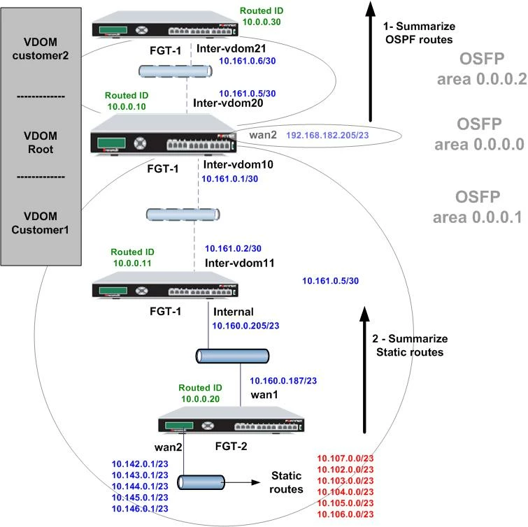

Diagram
The following network scenario is used for this example. Note the use of 3 VDOMs one FortiGate 1 (FGT1).
Expectations, Requirements
FortiGate 2 (FGT2) has multiple IP addresses on its interface wan2, with OSPF enabled 10.142.0.1/23 --> 10.146.0.1/23, and multiple static routes that are advertised in OSPF : 10.102.0.0/23 --> 10.107.0.0/23.
The goal is to summarize all those routes across the areas and the routers.
