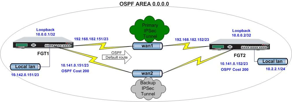

This article describes the steps to configure FortiGates in an OSPF scenario providing two redundant IPSec tunnels.
It includes the network diagram, requirements, configuration, and routing tables of all FortiGate units.
  • All FortiGate units.
  • FortiGate or VDOMs running in NAT mode.
Diagram
The following network diagram illustrates this example and how to setup OSPF over IPSec.
Expectations, Requirements
Requirements:
  • FGT1 will become automatically ASBR as it will advertise its static default route (see marker M1).
  • FGT2 will advertise its local LAN as OSPF internal route (see marker M2).
  • The primary routes must go via the tunnel over wan1, and routes over the backup tunnel only used when the primary is down (see marker M3).
The use of loopback interfaces into this OSPF scenario is a simple rule that eases the OSPF troubleshooting and administration, where we will set the OSPF router ID identically to the loopback interface.
To control the OSPF routes that are selected in the routing table, the OSPF interface cost will be used (see marker M3 in the configuration).

Verification
1- OSPF information and routing tables when primary tunnel_wan1 is up.
NOTE: All OSPF routes are seen via tunnel_wan1.

2 - OSPF information and routing tables when primary tunnel_wan1 is down.
NOTE: All OSPF routes are seen via tunnel_wan2.
