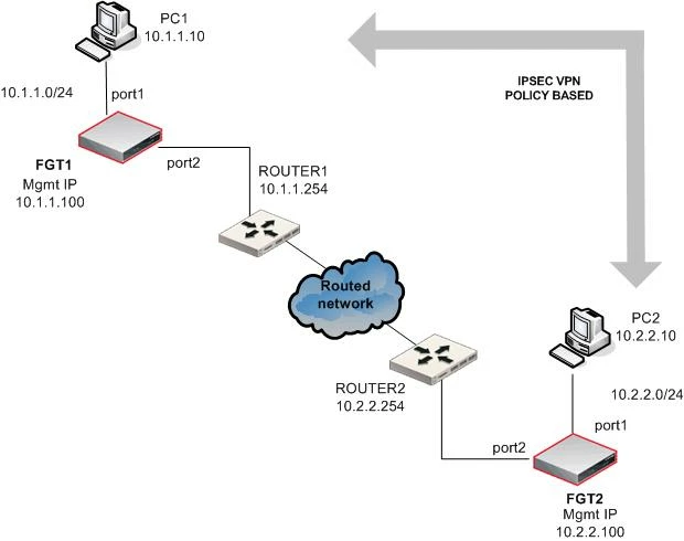

The following network scenario is used to illustrate this example :
Expectations, Requirements
Requirements for this example :
  • Because both FortiGate are not in the same L2 network (separated by routers), the hosts on each side must be on different subnets.
  • FortiGate management IP addresses must be in the same subnet as the local hosts
  • The default gateways (router1 and router2) for PC1 and PC2 must be behind port2 in order for the FortiGate to match the appropriate Encrypt firewall policy (port1 --> port2)
PC1 and PC2 which are in different subnets will be able to communicate via the IPSec tunnel.
